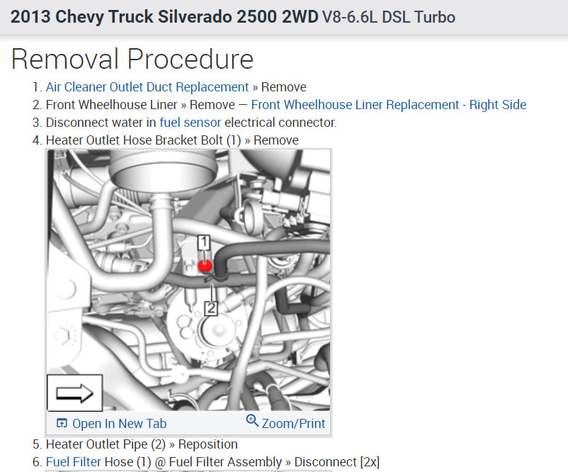

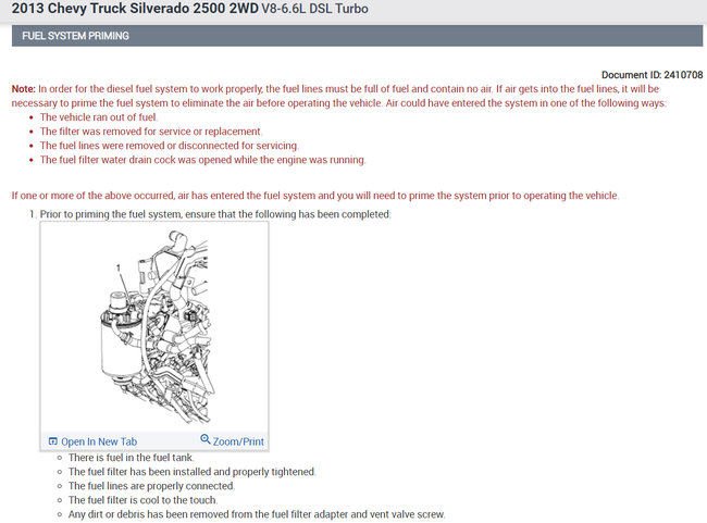

I took my chevy 2500 hd duramax diesel 6.6L to the dealership for a fuel filter change and after they changed my fuel filter my truck started idling high, riding rough, getting bad gas mileage and at high speeds it jumps really bad, it never did this before the fuel filter change and the dealership is saying they can't find the problem, they tried changing the fuel filter out but my truck is still doing the same thing. Will you please help me I paid them and they saying they don't know what's wrong with it.

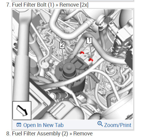

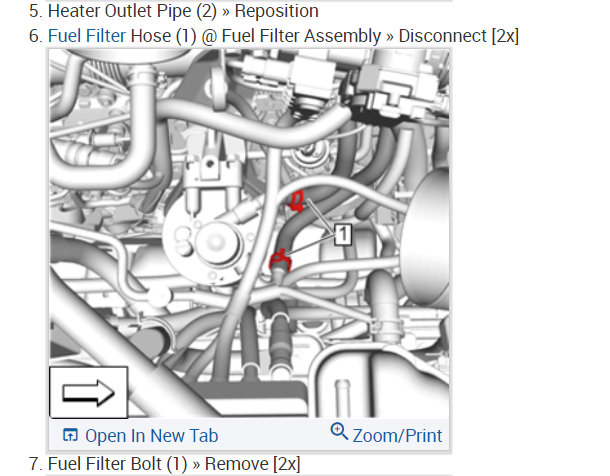

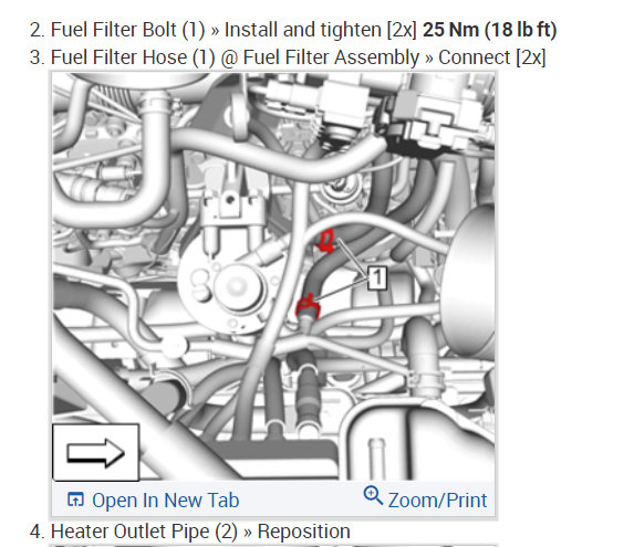

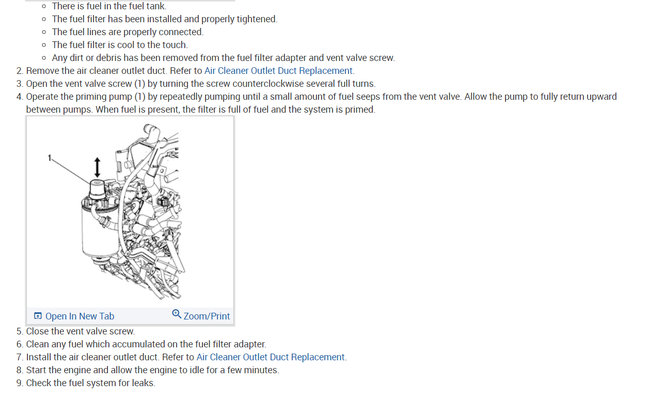

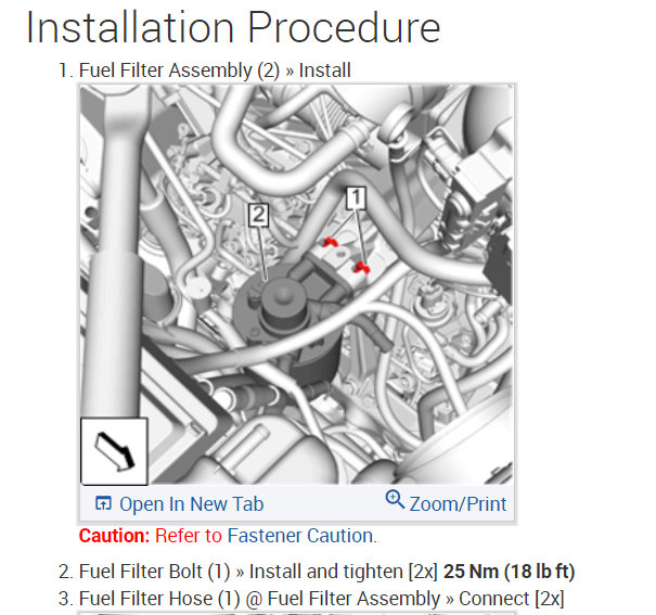

Hi Mauricejackson,
If the dealership could have bumped the plastic sensor on the top of the fuel housing, while starting the truck observe the housing to see if it is blowing bubbles? If so it is leaking which would cause the problem you describe. I have seen this happen before.
Or if they forgot to prime the system after the filter change it could have damaged the injection pump, hopefully not :-)

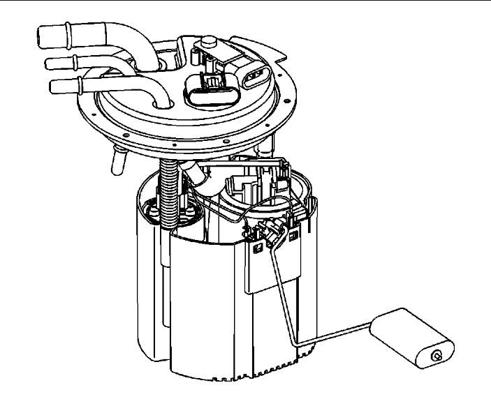

There is no fuel filter on the frame rail! Where is it located?
Monday, September 7th, 2020 AT 12:38 PM (Merged)
BMDOUBLE
  • 1,139 POSTS

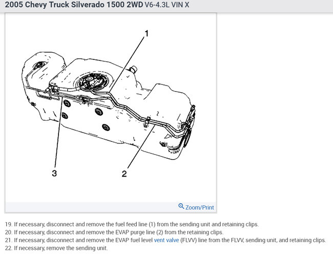

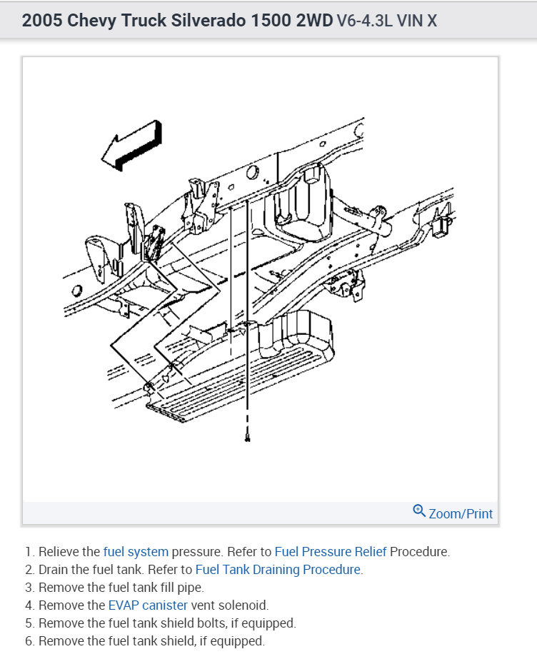

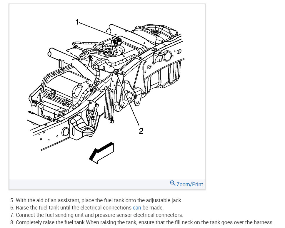

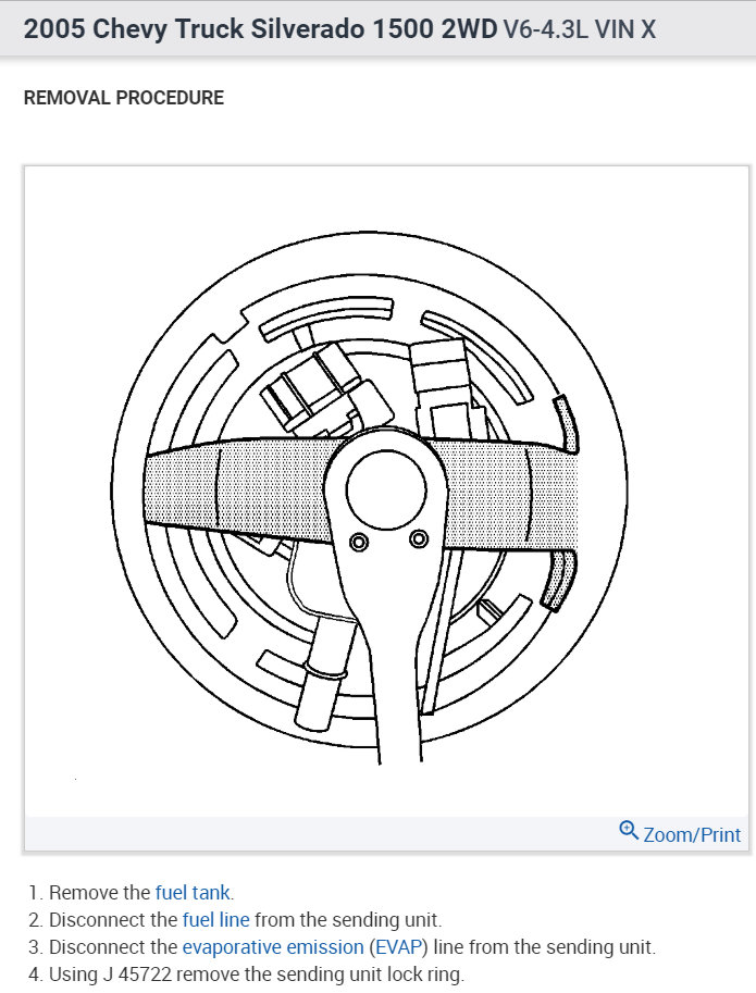

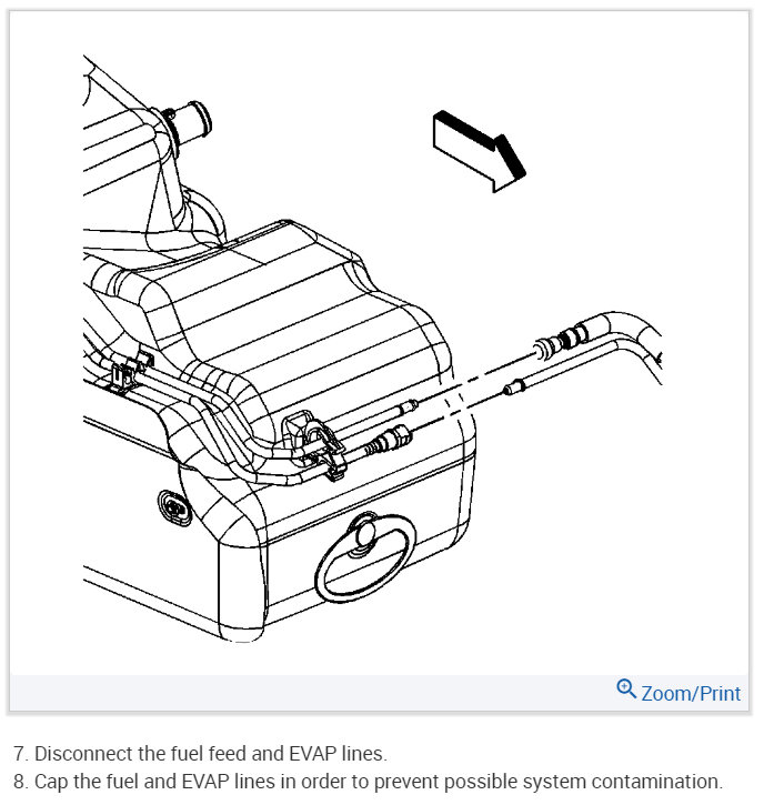

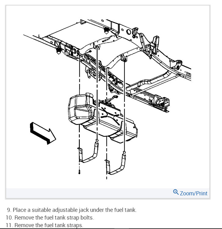

It is integral to the in tank fuel pump. Check out the diagrams (Below). Please let us know if you need anything else to get the problem fixed.

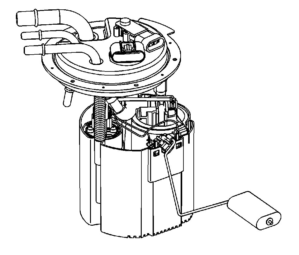

Where is the fuel filter on my 2006 silverado? Or does it not have one? I've heard they have a lifetime one? Not sure.
Thursday, September 10th, 2020 AT 12:07 PM (Merged)
  • 75,992 POSTS
The fuel filter is in the fuel tank also see below
https://www.2carpros.com/forum/automotive_pictures/12900_fuel_filter_2.jpg

Where is the fuel filter located, if there is one?
MERLIN2021
  • 17,250 POSTS
Inside the sending unit in the gas tank...no service interval given!
https://www.2carpros.com/forum/automotive_pictures/62217_2005Fuel_Filter_1.jpg

MARVIN RICHARDS
  • 2004 CHEVROLET SILVERADO
Engine Performance problem
2004 Chevy Silverado V8 Two Wheel Drive Automatic
where is the gas filter located and how is it changed
Thursday, September 10th, 2020 AT 12:08 PM (Merged)
HOOMIE24
Its located in the fuel tank
