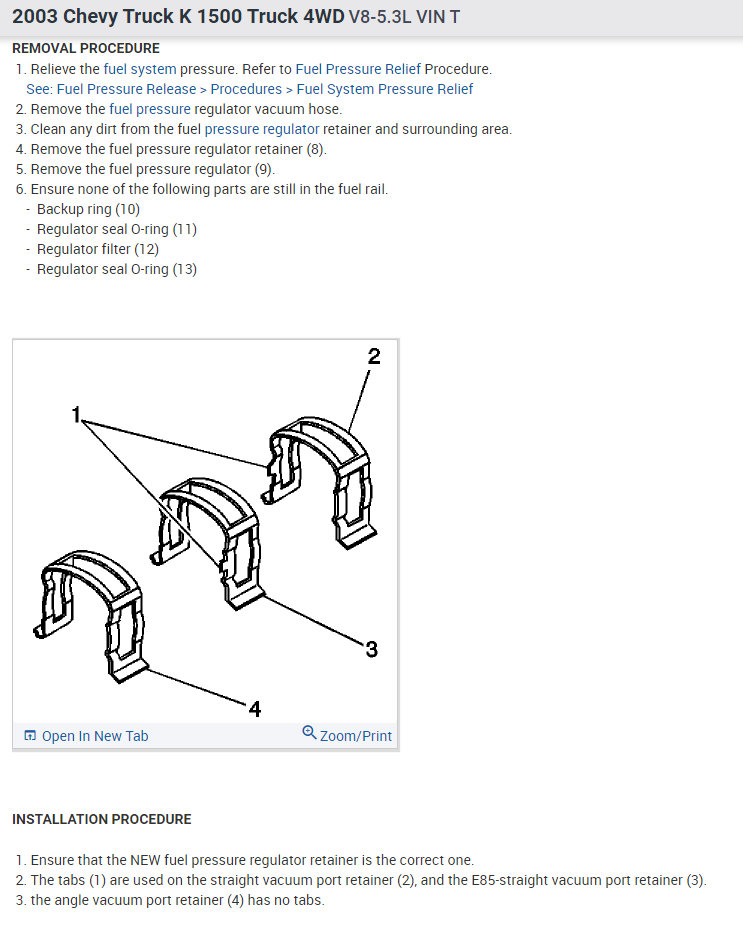

This has happened approximately 4 times; When trying to start engine it just cranks. I have to use fuel to prime. Then it starts right up. Why am I losing my prime fuel pump?
Wednesday, July 23rd, 2008 AT 3:29 PM
SQM
  • 6,383 POSTS

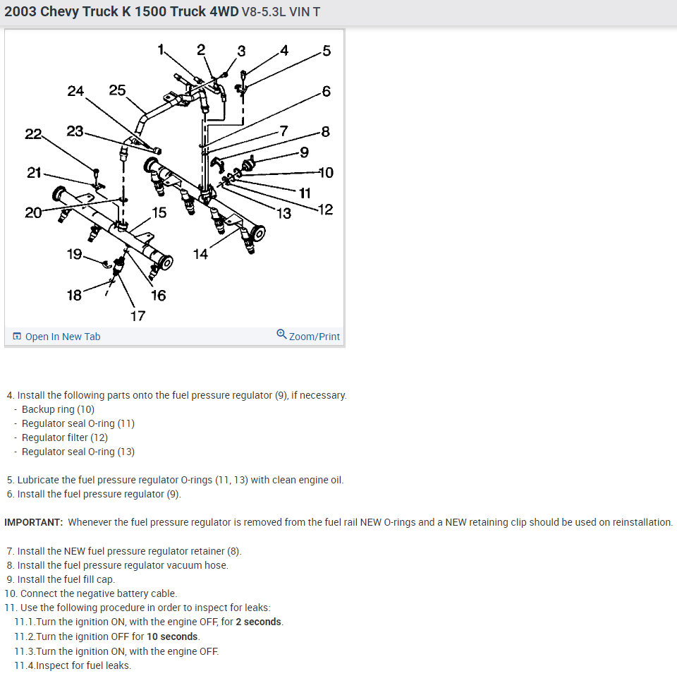

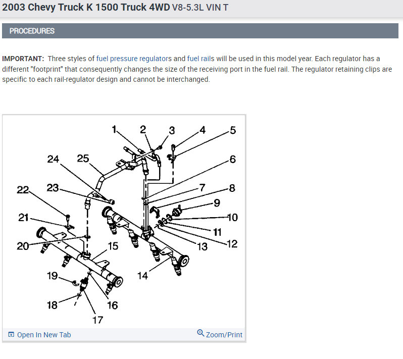

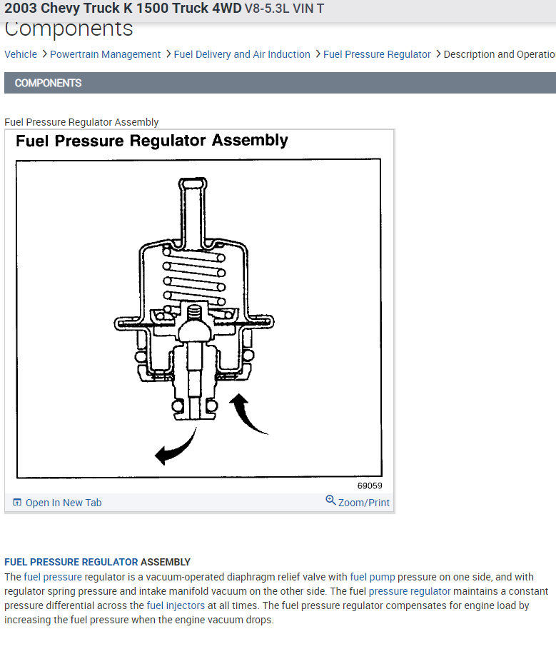

It sounds like you might have an issue with the fuel pressure regulator.
It might not be regulating the pressure correctly or not producing the right volume.
Check your fuel pressure with a tester.
You should have 55-62 PSI of pressure with key On and engine Off.
You might find this article helpful:
Here is a video shows how to check the fuel pressure:
https://youtu.be/aITQclp7zIE
I have attached the diagrams for your reference.
