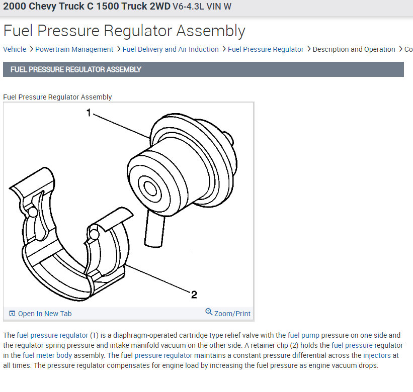

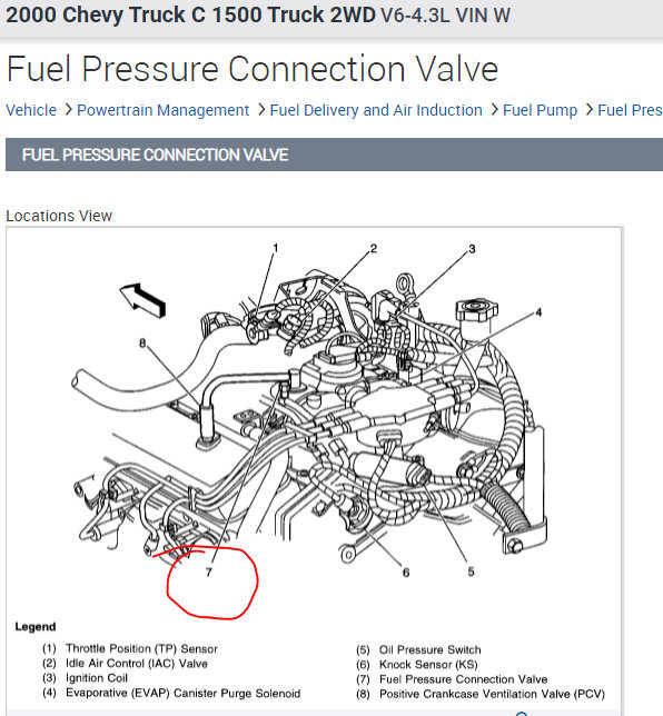

Check the fuel pressure make sure you are getting fuel.
You could have a clogged line somewhere which can prevent the fuel from getting to the engine, even though you have good pump and filter. You could have a bad fuel pressure regulator.
You should have 60-66 PSI of fuel pressure with the key On and engine Off.
Here is how to check the fuel pressure:

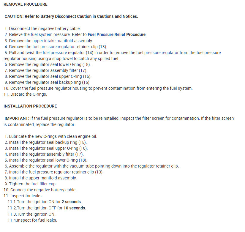

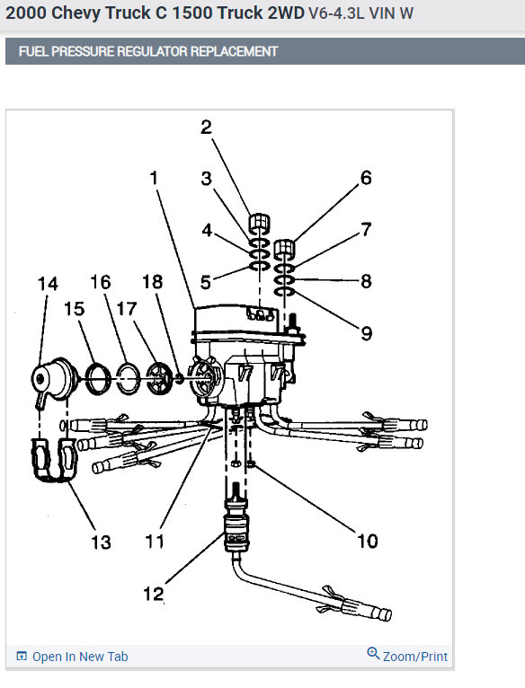

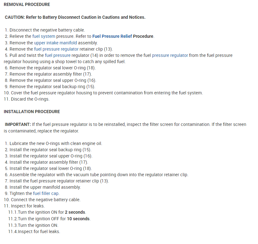

If you do not have correct fuel pressure check the fuel pressure regulator.
