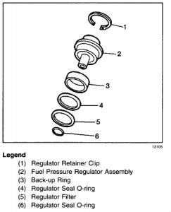

Where is the fuel pressure regulator located on the 7.4 liter vortec engine?

Fuel Pressure Regulator Assembly
https://www.2carpros.com/forum/automotive_pictures/12900_fp_54.jpg
The fuel pressure regulator is a diaphragm-operated cartridge relief valve with the fuel pump pressure on one side and the regulator spring pressure and intake manifold vacuum on the other. A retainer holds the fuel pressure regulator.
