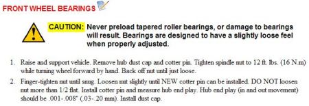

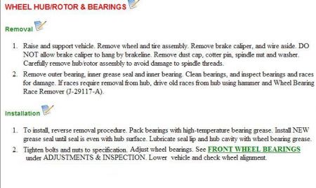

How do I change wheel bearing on 97 silverado?
Thursday, June 11th, 2009 AT 8:36 PM
BLUELIGHTNIN6
MECHANIC
16,542 POSTS
+1
Thursday, June 11th, 2009 AT 11:33 PM
