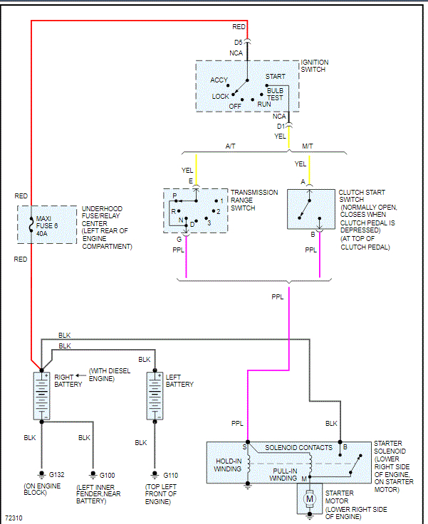

Either you have a bad solenoid or the starting circuit the purple wire is touching the positive battery cable/terminal at the starter.
Do this remove the small wire from the starter then hook the negative cable back up if it cranks over the solenoid is bad. If it doesn't then the purple wire is shorted to power could be at the ignition switch or somewhere in the wiring harness. This guide can help us fix it

I'd have to make sure the battery has a full charge and the battery connections are clean and tight on both ends. If you use a digital voltmeter leads across the battery posts, everything turned off, the generic spec for a full charge is 12.6 volts. With the leads still hooked up, have a helper turn the key to crank, while you watch the meter reading, it shouldn't drop below 9 volts, some specs say it should drop below 10 volts. A national brand autostore should be able to load test the battery for you and charge if necessary.
The starter solenoid S terminal, purple wire, should be hot with the key in the crank position? If it isn't, backtrack that circuit. It comes from the ignition switch to tranny range sensor to starter solenoid.

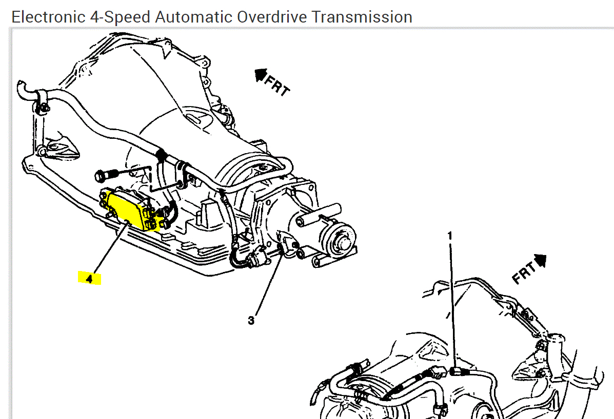

For about a month now, I've had trouble starting my truck. You could turn the key and all the normal dash lights come on, but when you turn the key to start it all the dash light go out and nothing, it does not crank. So I would move the shifter back and forth and it would turn over, but now even that doesn't work. Could it be the neutral safety switch or the starter or is it the ignition switch. I'm really stumped on this one if you have any ideas I really would like to hear them. Thank You for all you can tell me

You will have to test to see if neutral switch is getting and sending power. If not it's probably the ignition switch then test to see if starter is doing the same it's the yellow wire on neutral switch for input and purple for output. Starter is purple wire on "S" terminal. If neutral switch doesn't get power then it's the iginition switch.

Turn on the headlamps, turn key to crank, Is there any reaction from headlamps? If the lamps go out or almost then usually, suspect the battery or cables. If the lamps stay bright, maybe an open circuit to starter? If this is an automatic tranny, could be an issue with neutral switch. Could be an issue with starter itself? Some of the national brand autostores will test the starter for you.
Have you done any voltage testing at the starter, itself? Battery voltage at the starter is hot all the time. Crank voltage at the starter goes hot with key in the crank position. Any testing at the starter, make sure tranny is in park or neutral and the parking brake is set.

It could be the ignition switch. Remove the ignition relay located in the under the hood relay fuse box. Jump out the terminals that control the starter. If the starter turns over then it is probably the ignition switch -- if not then it is probably the starter solonoid.
