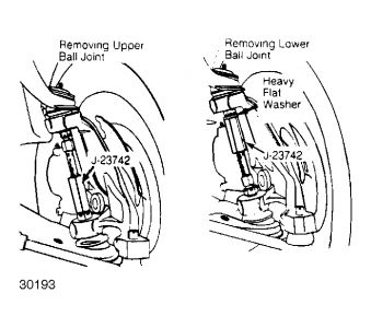

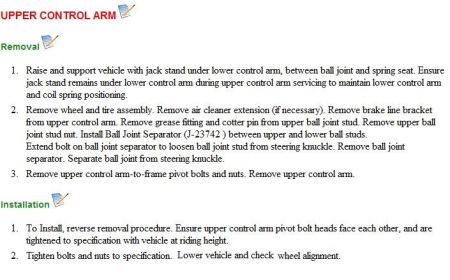

How do I successfully change upper right control arm on chevy 1500 pickup.
What r the rough spots and what to watch out for?
