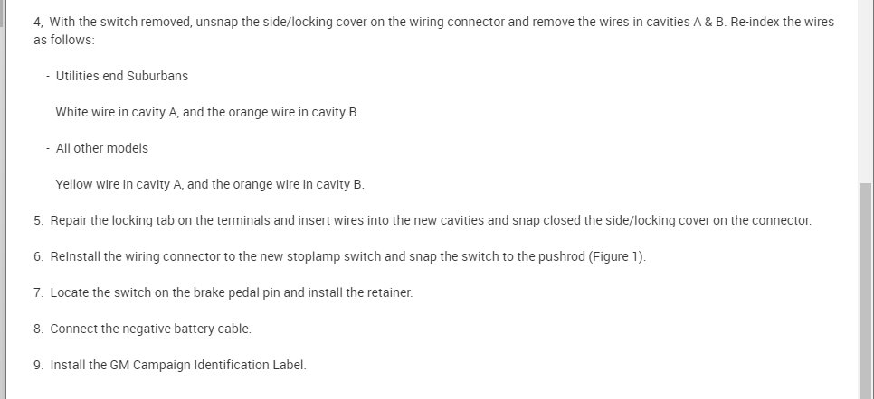

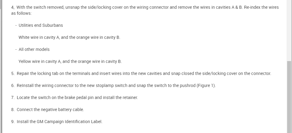

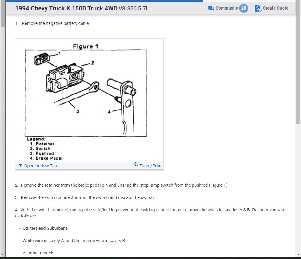

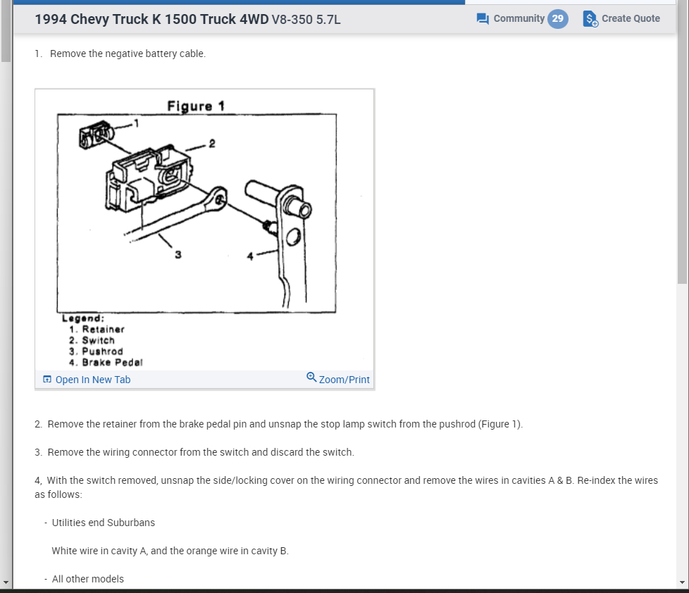

It is mostly likely you’re brake light switch, check your VIN there is a recall out for the 1994s I had the same issues. When you apply the brake you should hear a slight clicking sound by the brake pedal, if you do not it’s the switch hope this helped.
Wednesday, May 11th, 2022 AT 10:11 AM
Thanks for adding that info. You are correct that there is a recall out for those brake switches. I attached the info below on the process.
This post was from almost 14 years ago so it is unlikely to help them, but I am sure this will help others in the future.
Thanks again for jumping in on this and using 2CarPros.
