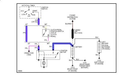

my truck has been sitting for 3yrs I changed battery, checked my fuses, pulled my starter had that tested its good. When I go to start it I get nothing. Not a click or anything my dashlights work.I cut my d.L.C.(Data link connector)out to use elsewhere. That wouldnt have no effect would it?I live in the mountains so taking it to the shop is out. Any help?Thank you 2carpros!
+1
Thursday, September 3rd, 2020 AT 5:21 PM (Merged)
  • 75,992 POSTS
Hold the key at cranking position and check for power at the starter solenoid small terminal with a pruple wire if there's no power -check the purple wire if its open to the ignition switch-NOTE: You do not have a NSS/Park and Neutral switch. Its from the ignition switch straight to the starter

Hi, It sounds like your battery cables might be the problem. Using a test light test for 12 volts at the starter. If you power is present replace the cable(s) Also, check the fusible links down at the starter to make sure they are intact. Thanks for using 2carpros. Com

If it's the starter clicking then there's a good chance it could be the starter.I would have the battery tested and make sure the battery cable's are clean and tight.Also do you have a multimeter or test light to do some testing when it act's up so we can see if it's the starter?
This guide can help us fix it
+3
Thursday, September 3rd, 2020 AT 5:23 PM (Merged)
ADAMHARVELL
The battery is new and fully charged, the cable connections are clean and tight. I do have a multimeter, but I'm not 100% on how to use it. At first the truck was starting more than not starting. Now the problem has gotten worse. It may start first try sometimes but when it fails, it makes a kinda loud click noise (sounds like its coming from the starter) and a lesser click noise when I release the key from the crank position.
SATURNTECH9
  • 30,869 POSTS
Since your not sure how to use the multimeter do you have a test light?Those are really easy to use. Let me know it sound's like a bad starter though I just want to be sure. Also make sure the positive battery cable to the starter is clean and tight. Make sure you check that with the negative cable unhooked from the battery. If you have a test hook the aligator clip to a ground when it doesn't start and see if you have power to the purple wire at the starter with the key in the start position. If you do bad starter. If we use the multimeter the black lead goes to the common connection on the meter and the red lead goes to the V connection on the meter. Then set the meter to 20 DC volts then ground the black lead and use the red lead to test for battery voltage at the starter purple wire with the key in the start position if you have battery voltage and the starter is inop bad starter. Let me know what you find.

It sounds like you had a fusible link burn out, probably due to a short somewhere else in the truck. If you burned out a fusible link and replaced it with regular wire, that is a big no no and can cause a fire or severe damage to the car. You need to find the short and repair it first and then replace the wire section with fuse wire.
