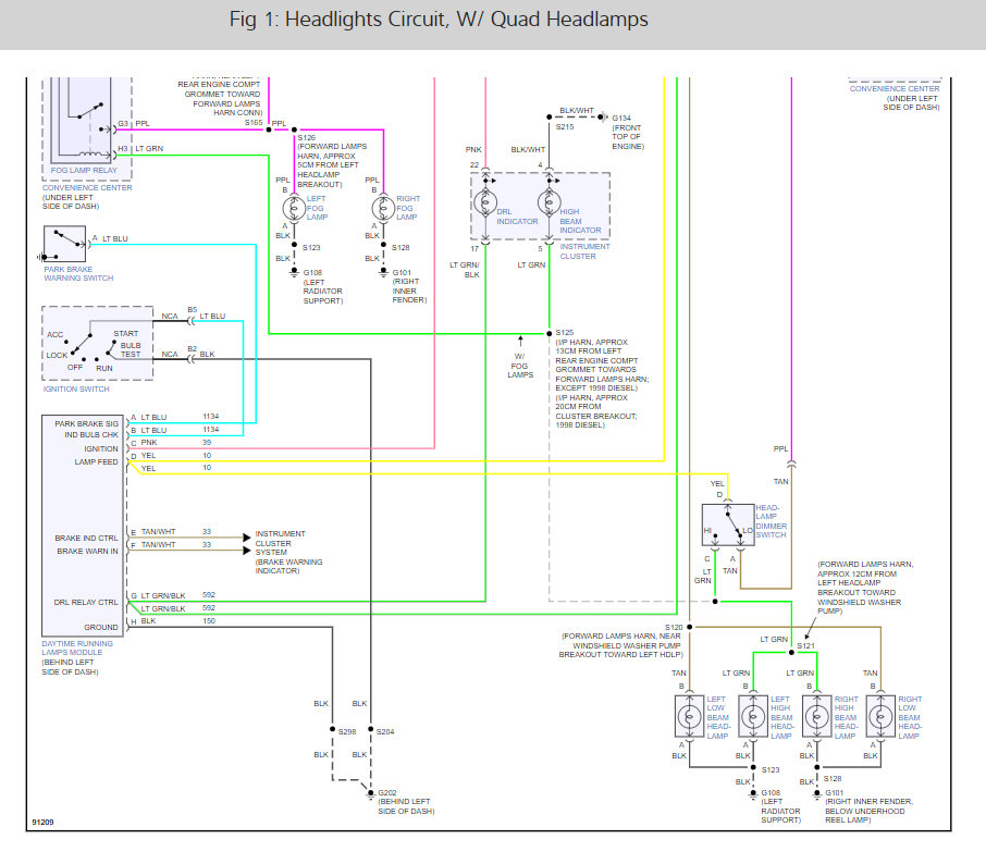

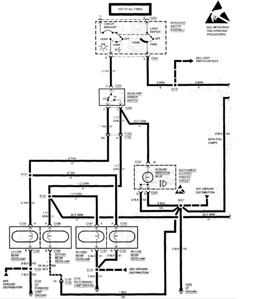

This is not a question but a answer for headlight problems on a 1998 Chevy K1500 Silverado. If you have daytime running lights but when you turn on your regular headlight on they do not come on. Take the bottom of your steering column off (Two Small Screws) and look at the back of your turn/dimmer switch make sure that the light blue wire is connected. The wires will break off after years of raising and lowering your steering column. Headlights not working

Great tip thank you so much for posting it. Here are the headlight wiring diagrams so you can see how the system works. Check out the diagrams (Below). Please let us know if you need anything else to get the problem fixed.

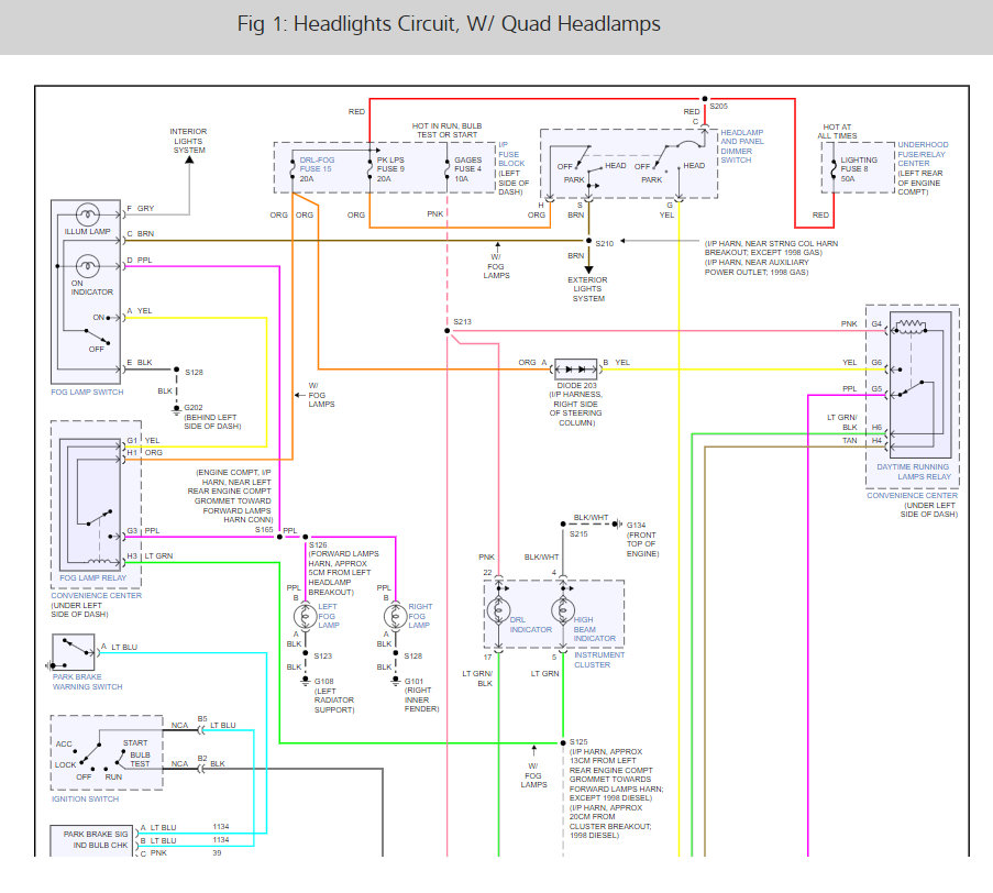

Okay, a couple of months ago I was working late and went to leave work and had no running lights as in tail and marker lights. So I had about fifty miles to drive home and all interstate mile I decided to go with my headlights and flashers and hope for the best. About ten miles down the road my flashers stopped flashing and were stuck on then completely stopped working, but I still had headlights and brake lights. One other thing the DRL's have not worked for about four years and I never worried about it because I really did not care. So I made the decision to pull into an auto parts store and see if I could fix this. First trip in I bought fuses and a flashlight. All the fuses were good and no headlight fuse could be found. So I thank GM for making it easy to remove the headlight switch almost by hand. I unplugged the switch looked it over and started jumping wires on the plug. The first one I got the marker lights. I went back in and they had a switch and I bought it and installed and I was on my way but with no flashers but hey at least I could be seen. So little did I know that this is the easy part. I installed a new flasher the next day and thought I was good, Less than a week later I lost my headlights after dark so I ran my flashers home. Since then I did some research and decided to take care of the DTR's too. I then changed the relay and the module for the DTR's diode. I got running lights and still no headlights or high-beams. More research pointing to the multi-switch on the steering column. Changed that. Still no headlights but every thing still works. Maybe I got a bad headlight switch. Next I pulled the plug on the new switch and started jumping wires again and the running lights came on and a couple terminals down the headlights came on and I pulled the lever for the high beams and they worked, must be I got a bad switch. Put a new one in and no headlights.

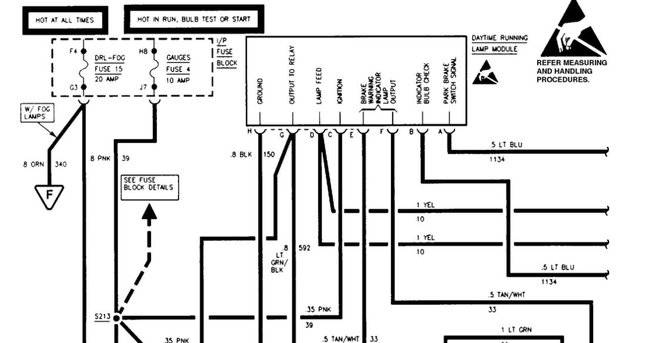

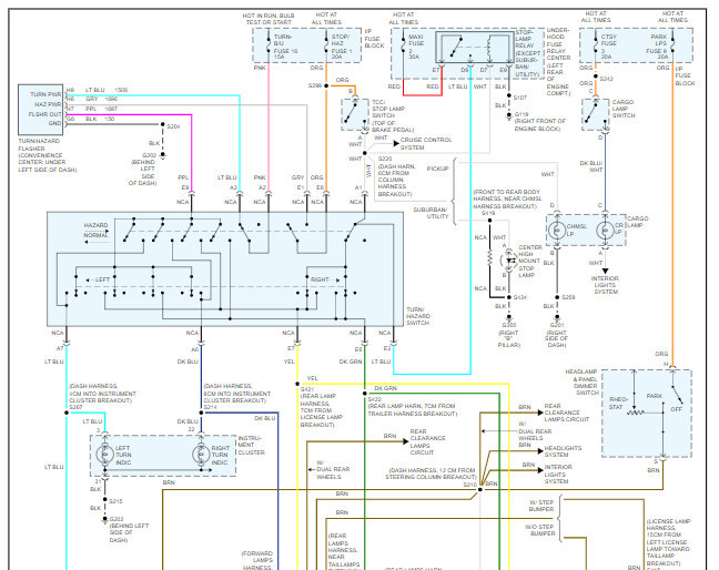

Good morning.
The headlight are actually controlled by DRL module. Very good chance that is your issue as the power from the lights goes from the headlight switch to the module and then to the lights.
-1
Monday, July 27th, 2020 AT 5:35 PM (Merged)
  • 52,797 POSTS
Found this diagram for you.
+1

Thanks Roy, that module is one of the first things I changed along with the relay under the dash next to the flasher relay. I did get my daytime running lights after I replaced the module.
+2
  • 52,797 POSTS
Okay, then verify there is power to the yellow wires coming out of the module. Also, make sure both fuse listed have power on both sides.
