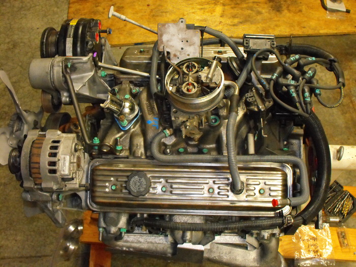

I just rebuilt my chevrolet Chevrolet K-2500 350 5.7L T.B.I. V-8 out of my 1992 K-2500. The engine had locked up so I rebuilt from the bottom up. When I start the engine the idle is rough and only keeps running with assistance. After about thirty seconds the engine will die no mater what
Engine is in initial start up and break in phase of rebuilding.
New piston Rings, main bearings, rod bearings, TPS, oil pressure sending unit, cam bearings, new stock camshaft, lifters, valve seals, professionally cleaned all engine parts, qualified all non replaced engine components, new timing chain.
Adjusted rocker arms, checked timing, verified vacuum hoses are in good order and correctly placed. Crankshaft was professionally ground and polished to 10/10.
