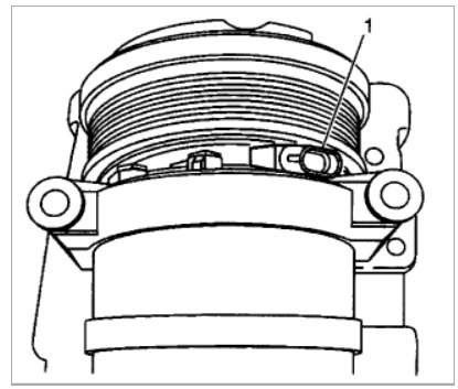

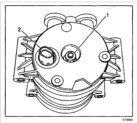

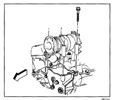

It sounds like you have a compressor that has gone out becasue the seals are worn out. Here is a guide to show you how to change the compressor out and vacuum down and recharge the system.
https://www.2carpros.com/articles/replace-air-conditioner-compressor
and
This guide may help as well.
Here is a belt diagram page for you too.
https://www.2carpros.com/diagrams/chevrolet/s10-pickup/2002
Tighten the bolts to 50 N.m (37 lb ft) .
Tighten the nut to 12 N.m (106 lb in) .
(Check out the diagrams below)

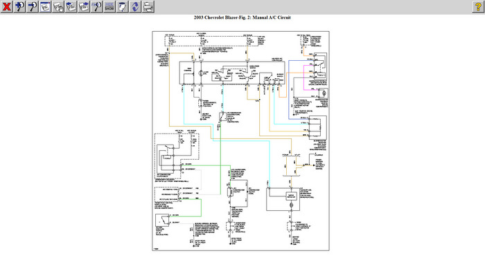

I am trying to hunt the failure to blow hot air and would like to be able to see the gm schematic of the parts layout of the heat/coolac system.
I can't find parts scematic for spit.
Help
Thanks
Nov 20, 2017 at 3:15 PM (Merged)
HMAC300
  • CAR REPAIR CONTRIBUTOR
  • 48,601 POSTS
if it's not blowing on high, it can be a relay, if not on the lower speeds then it 's probably the resistor. the resistor is by the blower motor. but i'll send your schematic.

AC not blowing cold air. The R-134 coolant is at the correct level. Changed the compressor relay. What is the next check? Oh and checked the fuses also.
THACKERY
Is the compressor clutch pulling in? Watch the front of the compressor when the ac is on the entire plate in front of the pulley should be turning.
Also, there are several AC fuses. Did you find them all?
I had a fuse blown for my AC, I think it was fuse #9 in the fuse panel inside the engine compartment.
