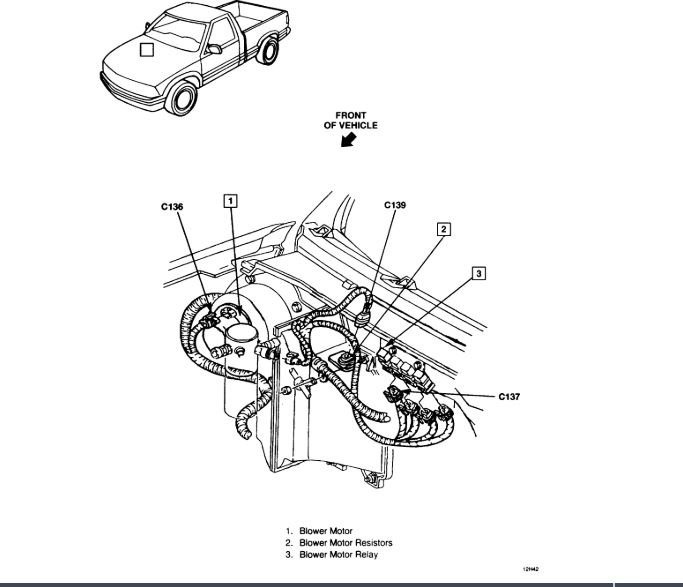

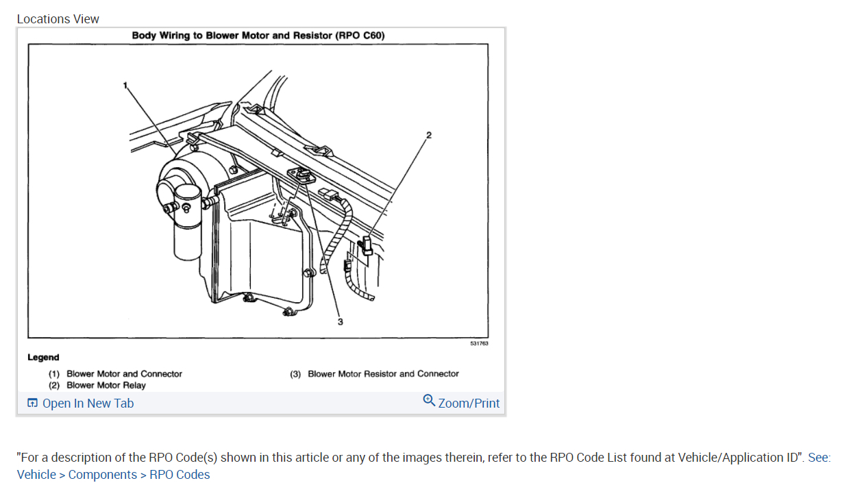

Where is the heater blower motor/fan and how do I replace it?

It is on the right side of engine compartment on firewall. Here is a guide to help you step by step with instructions in the diagrams below to show you how on your car.
https://www.2carpros.com/articles/blower-fan-motor-works-on-high-speed-only

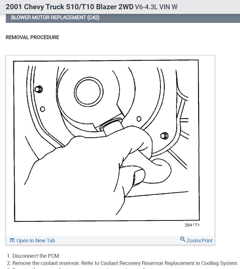

BLOWER MOTOR & FAN
Removal & Installation

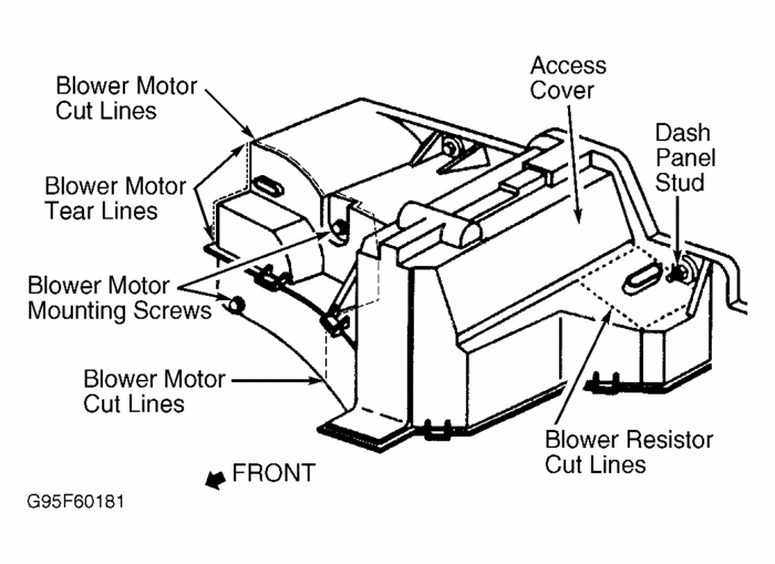

Disconnect negative battery cable. Disconnect blower motor electrical connections. Remove Vehicle Control Module (VCM). Remove coolant recovery reservoir and blower motor cooling tube. Remove blower motor mounting screws.
Cut access cover along dotted lines. See Fig. 5. Remove upper half of access cover, tearing remaining portion of access cover. Remove blower motor. Remove nut attaching blower fan to blower motor shaft. Remove fan.
To install, reverse removal procedure. After reinstalling cut-out portion of access cover, apply a bead of Black weatherstrip adhesive to cut and tear lines of access cover.

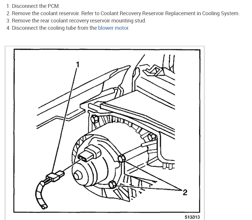

1.Disconnect the negative battery cable.
2.Disconnect the PCM.
3.Remove the coolant reservoir.
4.Remove the rear coolant recovery reservoir mounting stud.
5.Disconnect the cooling tube from the blower motor.
6.Disconnect the electrical connector.
7.Remove the blower motor mounting bolts.
8.Remove the blower motor.

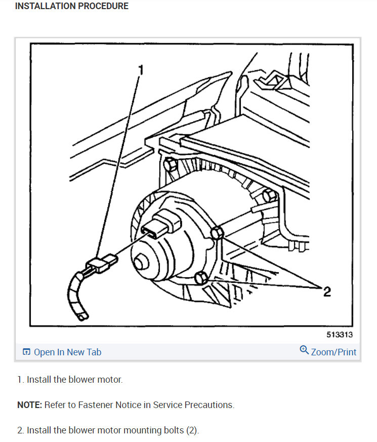

https://www.2carpros.com/forum/automotive_pictures/249084_blow_3.jpg
Fig. Blower motor removal-deluxe, outside air
To install:
1.Install the blower motor.
2.Install the blower motor mounting bolts and tighten to 40 inch lbs. (4.5 Nm).
3.Connect the electrical connector (1).
4.Connect the cooling tube to the blower motor.
5.Install the rear coolant recovery reservoir mounting stud.
6.Install the coolant reservoir.
7.Install the PCM.
8.Connect the negative battery cable.

Thanks Joe. Great instructions and easy to do. Really appreciate the diagram.

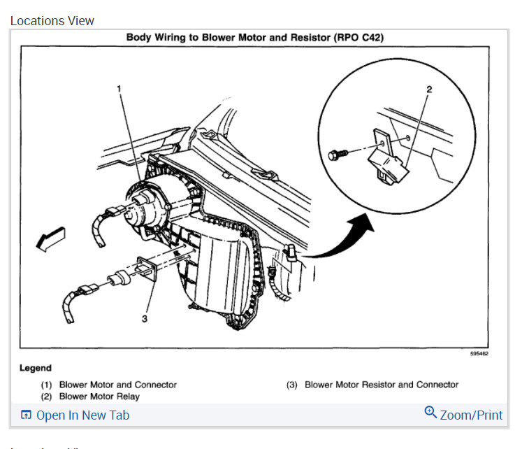

Good evening,
The blower motor is located under the hood, passenger side of the firewall. It has an electrical connector and five small screws that hold it into the housing.
Below are the procedures and a picture of the location for you to view.
https://www.2carpros.com/articles/low-or-no-air-flow-from-vents
REMOVE OR DISCONNECT
1. Negative battery cable.
2. VCM, if equipped.
3. Coolant recovery reservoir.
4. Blower motor cooling tube.
5. Screws.
6. Blower motor and fan assembly.
