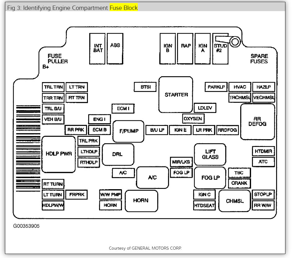

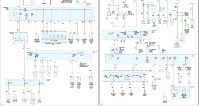

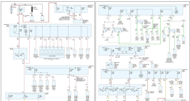

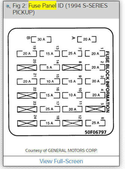

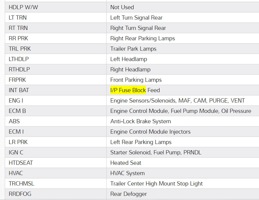

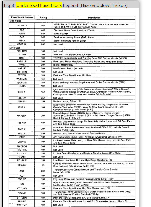

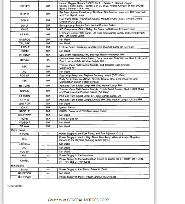

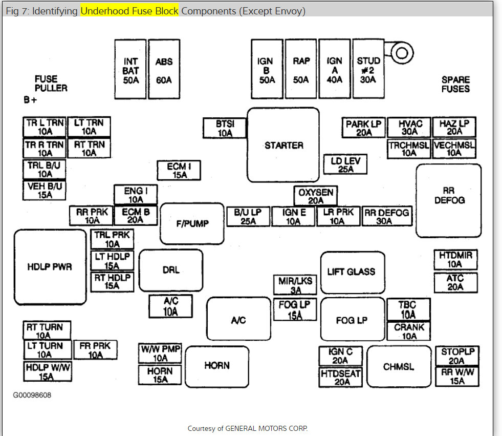

I tried to do some welding without disconnecting the neg. Cable. This apparently fried the starter relay inside the fuse box because it got to a point where it wouldn't stars without a light charge. Replaced the relay & things were going fine but this week when I don't use the truck every day the battery drains down to the point that a light charge ( maybe 2 mins) is needed & then I can go all day. Charging system, battery, starter all check out in good to excellent condition according to O'Reillys tester. We have an abnormal amount of pot-holes here & I'm wondering if something got shaken slightly loose or do I need to check the fuse box can I get diagrams please?

Check for a drain with everything off. I don't have the specs right in front of me, usually 30--50 ma/milliamps, .050 not even a tenth of an amp. If the drain is excessive, you pull/replace fuses one at a time, when you pull the fuse on the problem circuit, the excess drain goes away, then you check that circuit. You can also unplug the bat terminal at your alternator to make sure the drain isn't going that way?
Here is a guide to help you step by step with instructions in the diagrams below to show you how on your car.

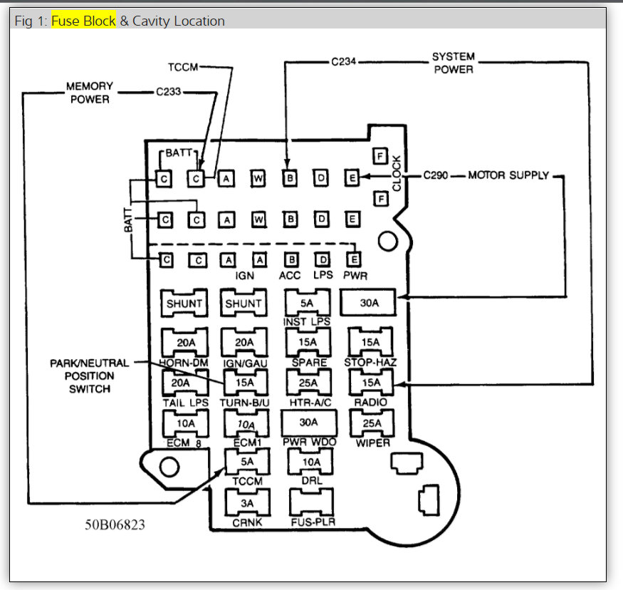

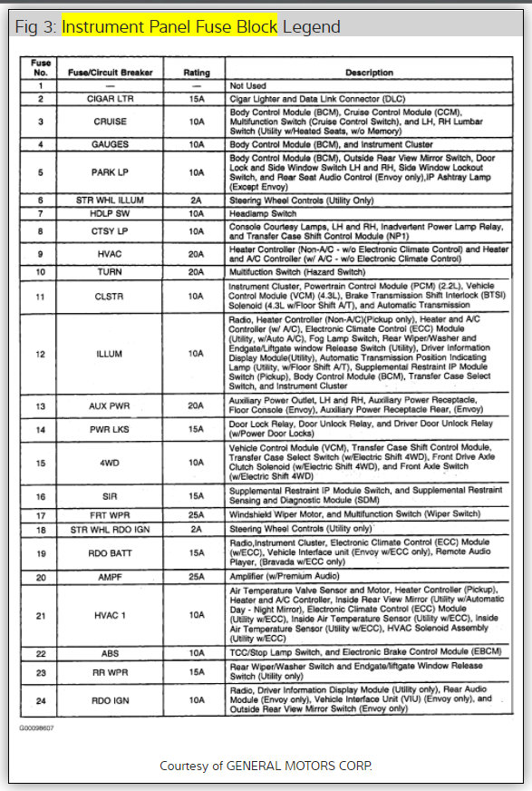

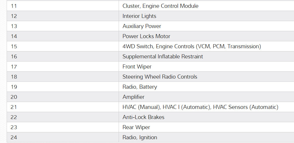

The fuse for my ecm/bcm (computer) on my 1998 chevy s10 keeps burning out. Then I have to shake the fuse block t get the vehicle to start again. I can't imagine the fuse block is bad, would anyone know why this would happen?
Thursday, January 7th, 2021 AT 3:25 PM (Merged)
WRENCHTECH
  • 20,757 POSTS
Yes, the fuse block could be bad. A high current circuit will get hot over time and when the contacts get hot, they lose tension and contact. Check out the fuse panel diagrams (Below). Please let us know what happens.

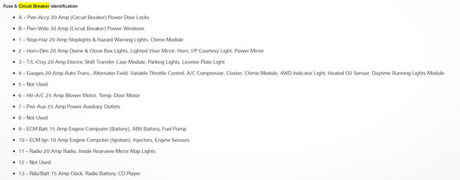

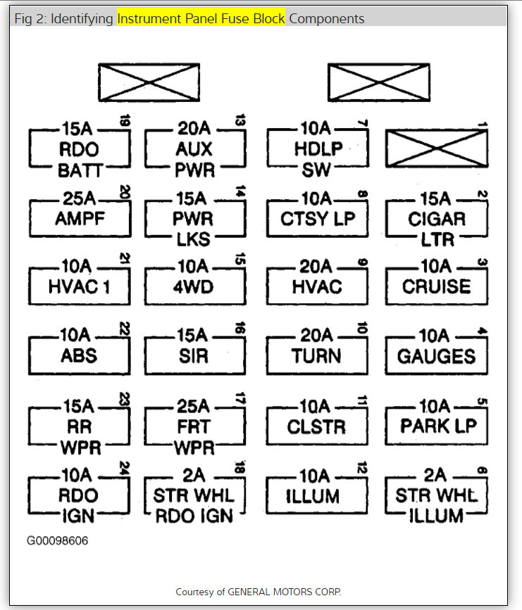

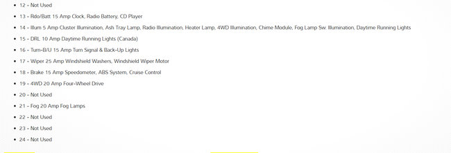

All my dash lights and my tail lights do not come on. Is there a fuse box under the hood somewhere or should I be looking for something else?
Answer I got so far: All use the same fuse, check fuses, if all fuses tested okay pull and check the switch and the wires connecting to it. But where is the fuse located? All the fuses in the dash are okay. Is there a fuse box under the hood somewhere?
  • 75,992 POSTS
Hello, here is a guide to help you test the fuses and the fuse panel diagrams below:
Cheers

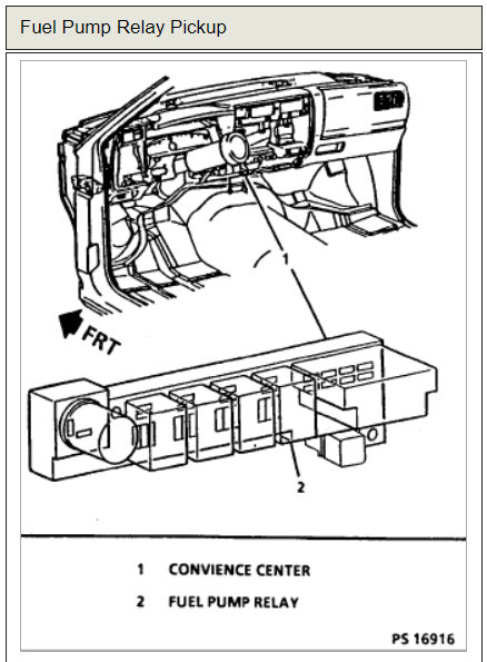

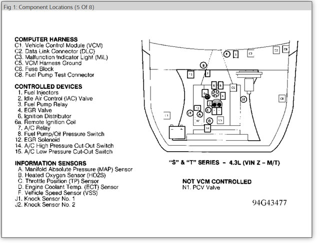

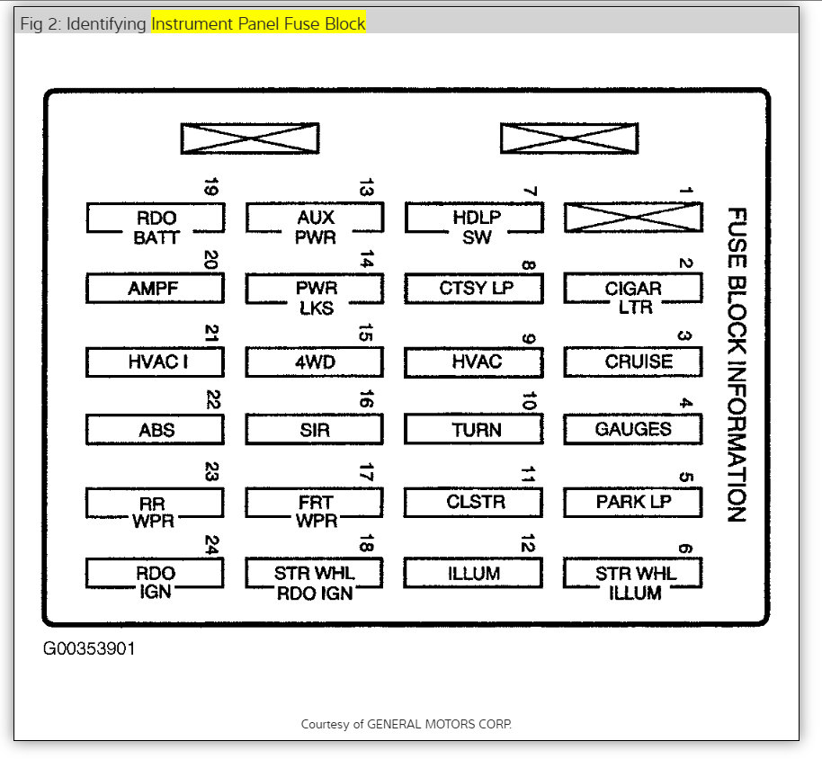

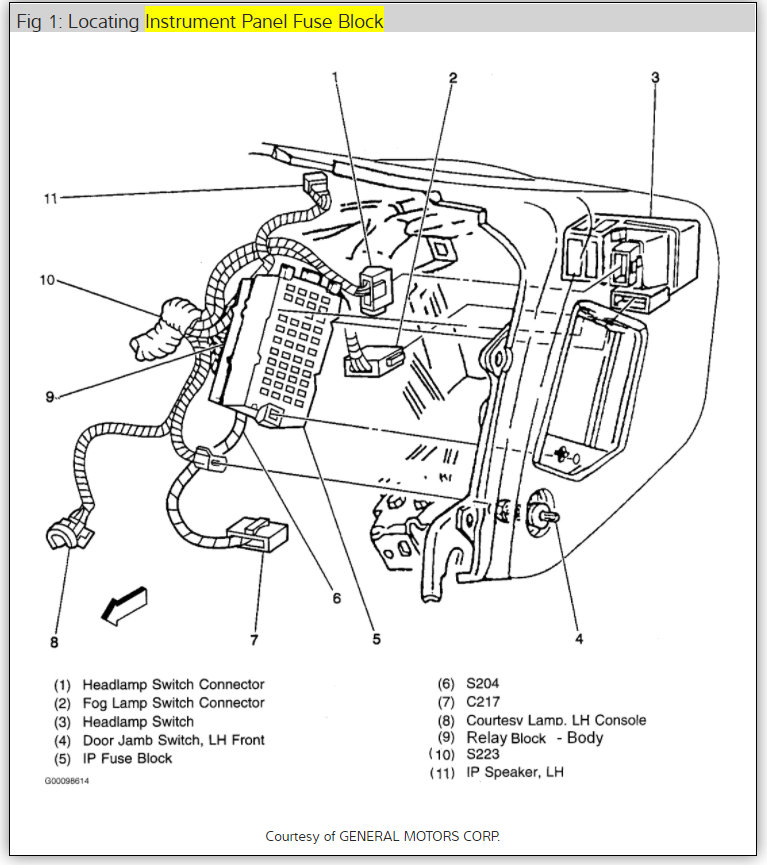

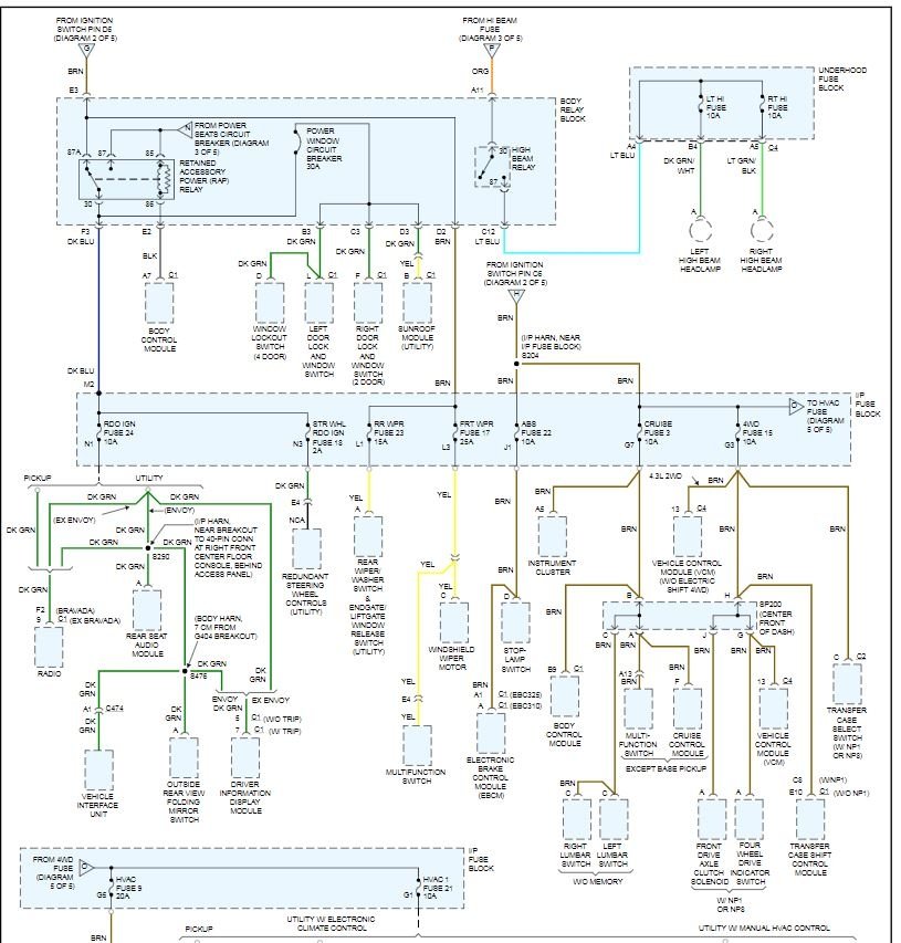

Where is the fuse box that houses the EMC, Ign, and Fuel pump and eng controling fuses at?
Thursday, January 7th, 2021 AT 3:26 PM (Merged)
  • 108,262 POSTS
It should be under the instrument panel to the left of the steering column.

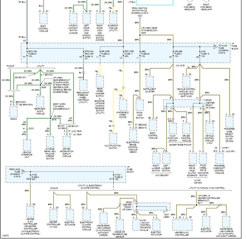

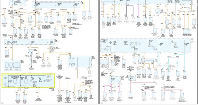

Attached below are all of the power distribution wiring diagrams

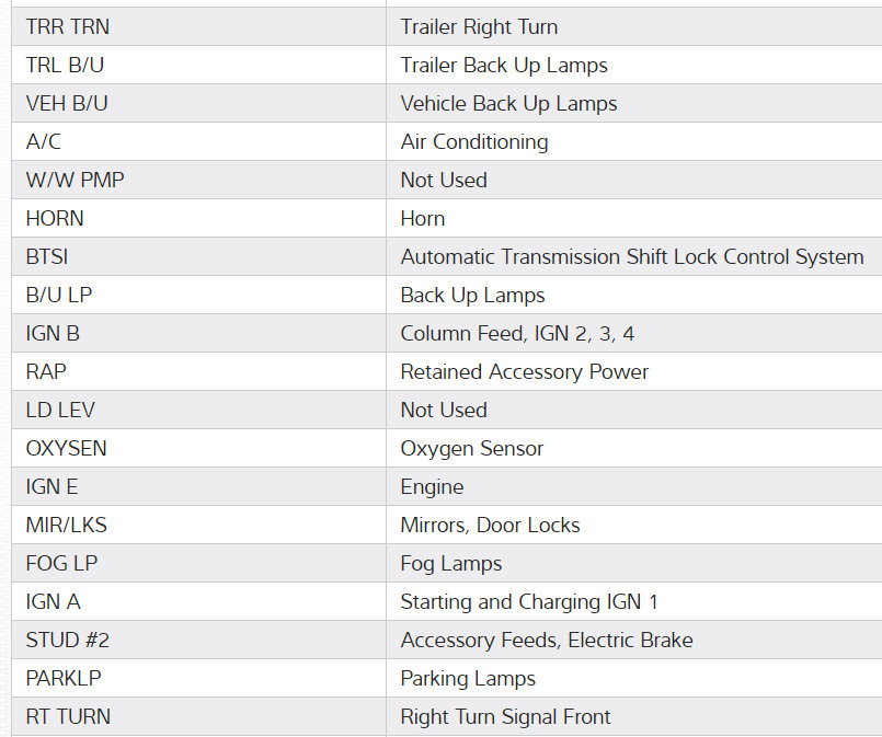

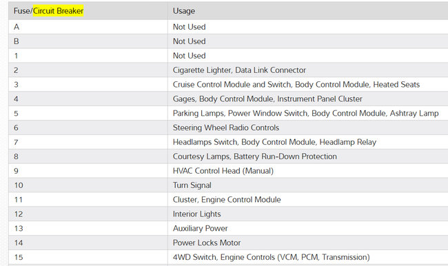

My interior lights are not working. (Dome light, light under the dash) but my dash lights are working. I've wiggled all the fuses but I don't know exactly which fuse is for the interior lights. Is there anything else that might be wrong?
CARADIODOC
  • 33,752 POSTS
Here is a guide and the fuse locations so you can test for power at the fuse. Check out the fuse panel diagrams below.
