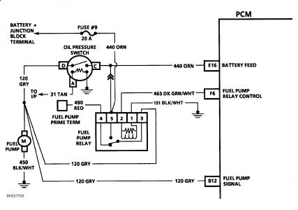

BMRFIXIT
  • 19,053 POSTS
Fuel Pump Oil Pressure Switch (Back-Up Circuit)
To test fuel pump oil pressure switch back-up circuit, start engine. With engine running, disconnect fuel pump relay. If engine stalls, fuel pump oil pressure switch is faulty. If vehicle continues to run, switch is okay.
https://www.2carpros.com/forum/automotive_pictures/99387_Graphic1_379.jpg
