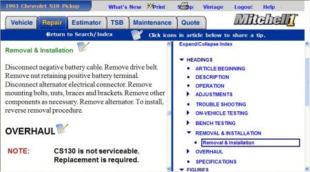

1993 Chevy S-10 6 cyl 188000 miles
I need to know how to take out the alternator on my truck so I can replace it
Monday, February 4th, 2008 AT 7:48 AM
MECHANIC
75,992 POSTS
Tuesday, February 5th, 2008 AT 2:27 AM
