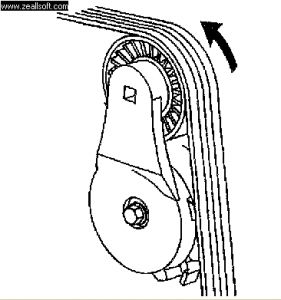

How do you put the fan belt back on once you replace the alternator

From under the truck install 3/8 drive wrench on the drive belt tensioner arm and rotate arm counterclockwise
install belt and slowly release
good luck
