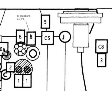

If your saying the pump runs with the key off, check the oil pressure switch.
Use a noid lite on the injector plug, see if there is a pulse with the engine cranking? The lite should pulse.
Tuesday, March 10th, 2009 AT 9:02 AM
TILLDOWN
  • 7 POSTS
The injectors will spray if I pour fuel into the throttle housing to start the truck. But if I turn it off and try to restart it, they won't spray and the pump just continues to wind, but won't shut off. Have to pour gas back in to get it to idle.
Went to the junkyard and replaced the whole injector housing with a used one, and still nothing. Pump still just continues to prime and won't shut off, and it won't start.
New injectors are expensive so i'm trying to avoid buying them until I have to.
Where is the oil pressure switch?

https://www.2carpros.com/forum/automotive_pictures/170934_89_s10_1.jpg
This info is for an 89 s10 4.3.

Ok thanks. I'm pretty much down to that, the fuel pressure regulator (which i'm also not sure of the location) or the injectors. Oil pressure regulator is the cheapest, so I guess i'll start there.
