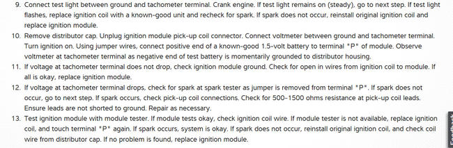

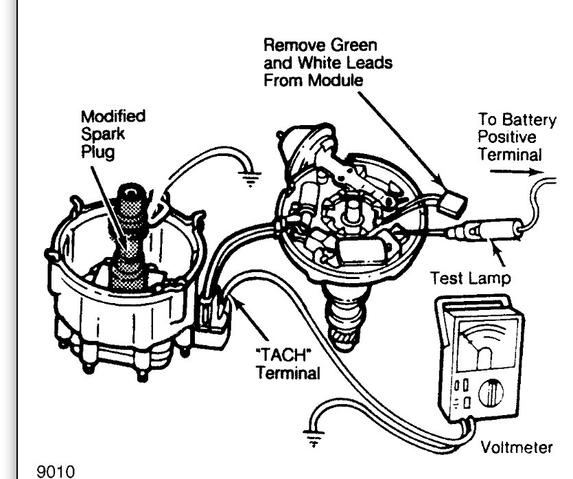

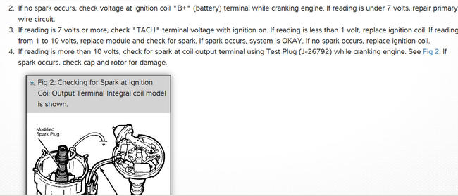

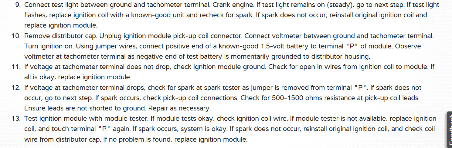

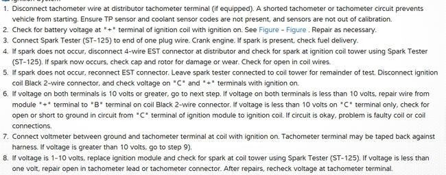

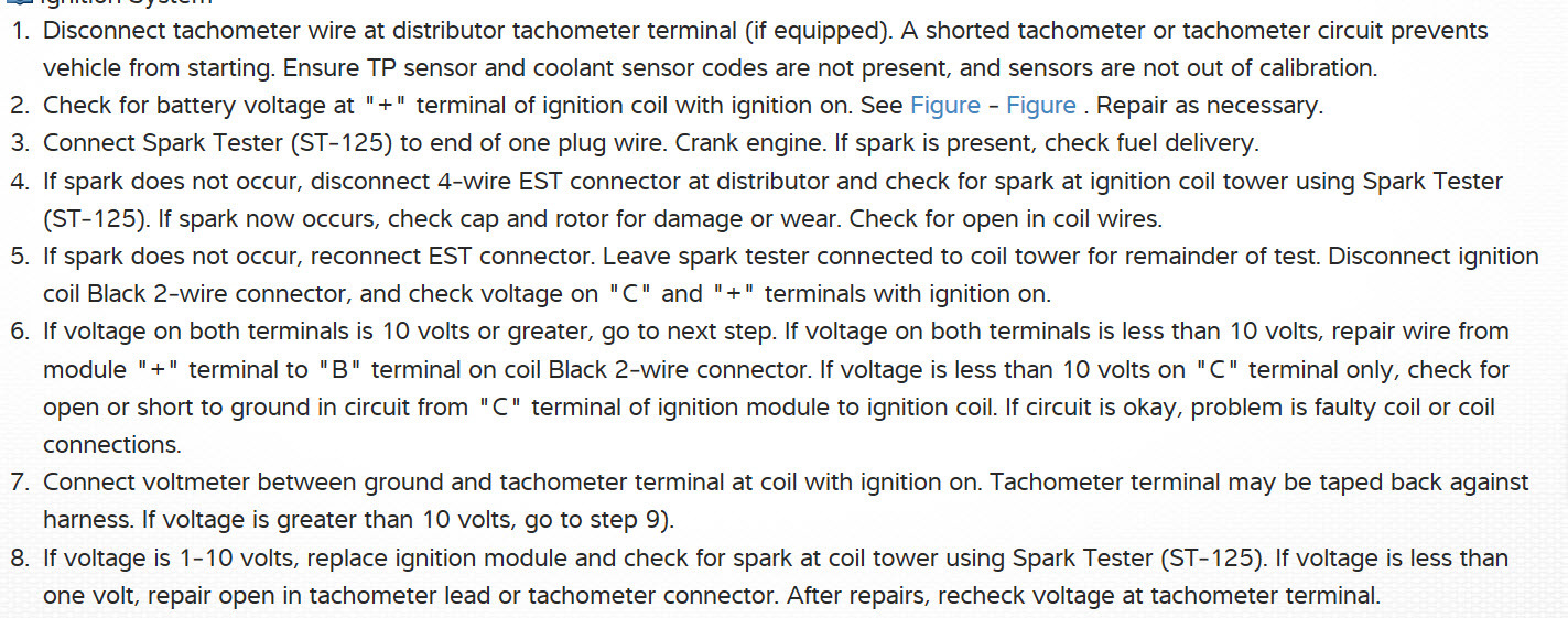

Did you check primary voltage at the coil, pink wire, goes hot with key on.
https://images.2carpros.com/forum/automotive_pictures/170934_s10_ignition_1.jpg
This guide will help https://www.2carpros.com/articles/how-to-test-an-ignition-system Please run down this guide and report back.

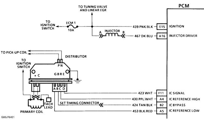

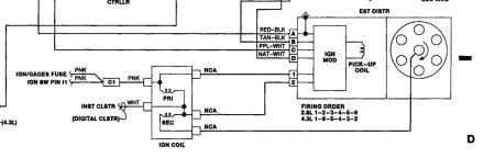

HMAC300
  • CAR REPAIR CONTRIBUTOR
  • 48,601 POSTS

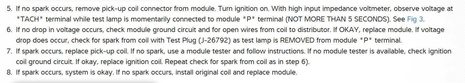

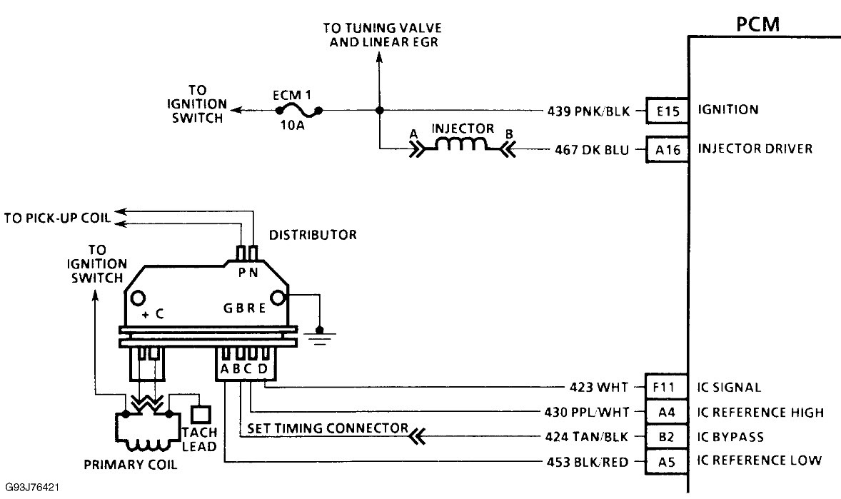

see pics for diagnosis
Jul 13, 2020 at 1:17 PM (Merged)
HMAC300
  • 48,601 POSTS
disregard my first reply I looked at wrong year this is correct see pics also check all fuses as well.
OREGONGUY
Okay, thank you and I'm not to tech on cars just normal base just replacing genral parts. I will show diagram to my buddy that has more technology then me..

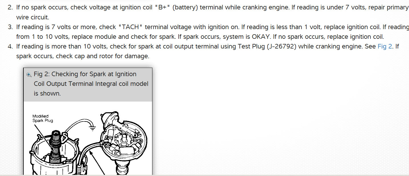

I first need to know what kind of S-10 is it a pickup or blazer? Have you checked ignition fuse number 5? It should be next to the horn fuse and it should be a 20 amp. Also check fuse 9 should be 15 amp and fuse number 10 should be 10 amp. Get back to me with what you find and the needed info so I can look over the wiring diagram and see what we can't do to get this thing running again.

Welcome to the forum, if the coil is separate from the cap, take coil wire loose from cap, hold close to engine ground, engine cranking, does spark jump, if so, suspect the cap or rotor. Use testlite on coil negative terminal, engine cranking, the lite should pulse.
If the coil is in the cap, use a teslite on the tach terminal, it should pulse, engine cranking. The cap and or rotor could also be an issue.
