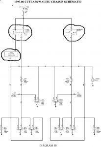

tail lights will not turn off stays on all the time

Check for a shorted headlight switch, or a shorted park light relay.
(sending diagram to your email)
