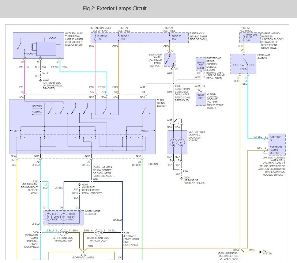

welcome to the forum, The high-mount brake lights are wired differently than the lower brake lites. The lower brake lights and tunr signal use the same bulb filament just not at the same time. If the turn signals work ok, then the wiring circuit from the multifunction switch should be ok. There may be an issue with the multifunction switch?
This guide should help us fix it

This sounds like you have a turn signal switch that has gone bad. Here is a wiring diagram of the brake lights and a guide so you can do some testing to confirm the failure.
Please run some tests and get back to us we are interested to see what it is.

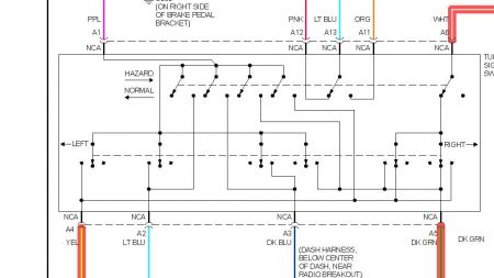

if brake switch, fuses and bulb are all good and high mount brake light works then suspect faulty turn signal (multi function) switch. main brake lights run through turn signal switch, high mount brake light runs through separate circuit on a relay switch.

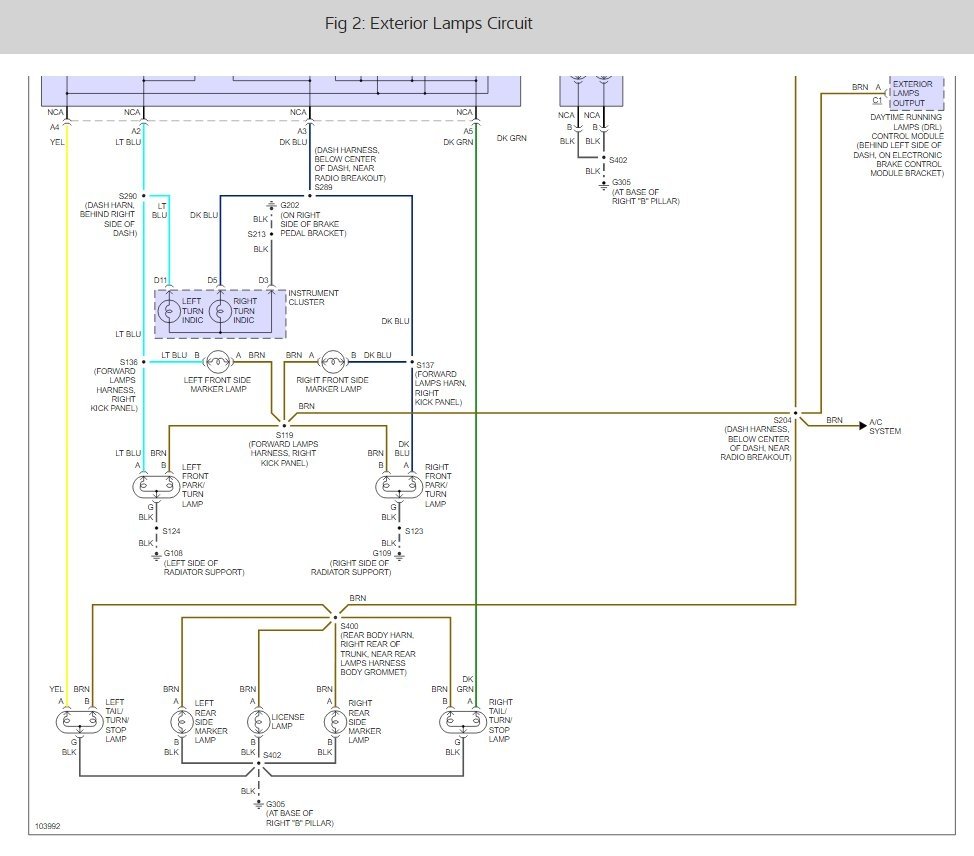

The power to the turn signals and brake lights comes from the turn signal switch-if it malfunction you won't have the lights.
https://images.2carpros.com/forum/automotive_pictures/12900_brake_5.jpg

The parking lights get turned on thru the head light switch the turn signals get turned on thru the turn signal switch.Then the brake lights get turned on thru brake switch.So what were you asking?Do you have a multi meter and test light?

Brake lights won't work unless I pull the turn signal lever towards me as I step on brake pedal.
Aug 15, 2020 at 11:13 AM (Merged)
STEVE W.
  • CAR REPAIR CONTRIBUTOR
  • 15,158 POSTS
Hello and welcome to 2CarPros. That would indicate that the turn signal switch inside the steering column has failed. It is actually a common issue for them to fail. Replacement starts with removing the steering wheel and then the column so that the wiring harness can be slid in and out of the lower column.
This guy tried doing it with the column in the car. The plate he has a problem removing has a retainer ring above it as well as being pressed on. This is when having the special tools to take the column apart are needed. It is possible to do it in the vehicle but not as easy.
