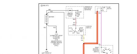

Have 12 volt to small purple wire on starter when ignition in crank position. Fat red wire at starter hot 12V from battey all the time. Replaced ground wire from starter to battery. Car still will not start.

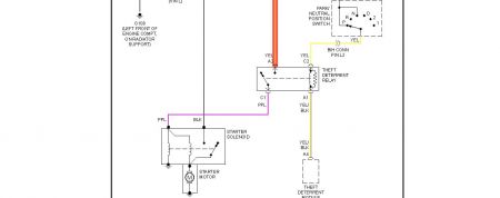

I remain stumped on my 1995 Lumina not starting problem. Had starter bench checked by three different shops. Starter cks out good on bench. Positive wire from battery to starter solenoid clean, no corrosion, attached to big stud on solenoid & reads 12.5 volts to ground at solenoid. When ignition switch is held in crank position small purple wire on solenoid reads 12.5 volts to ground. Installed new ground wire from battery neg post to block. Starter will not offer to turn. Solenoid does not engage. Nothing.

Check fuse no.11 5amp, If it has a theft deterrent device -check and test the theft deterrent relay and the theft deterrent module
https://www.2carpros.com/forum/automotive_pictures/12900_s1_63.jpg
https://www.2carpros.com/forum/automotive_pictures/12900_s2_57.jpg
