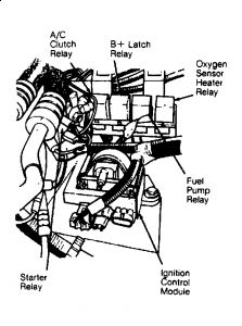

Does anyone know where the fuel pump relay is on a 1989 jeep cherokee, 4.0 liter. There are several relays in the relay box but they are not labeled.
Thanks
Thursday, February 23rd, 2006 AT 8:18 PM
BLUELIGHTNIN6
MECHANIC
16,542 POSTS
On relay block, on right wheelwell..
