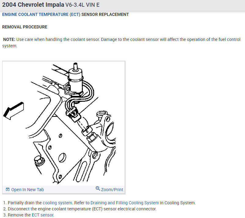

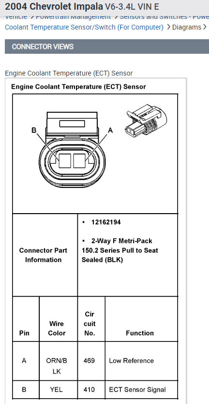

It sound like you might have an issue with the coolant temperature sensor.
The faulty temperature sensor providing incorrect info and when the vehicle thinks the engine it "too hot" it shuts down to prevent further damage to the engine.

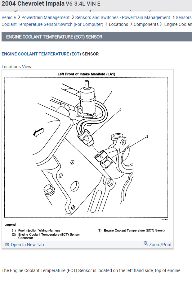

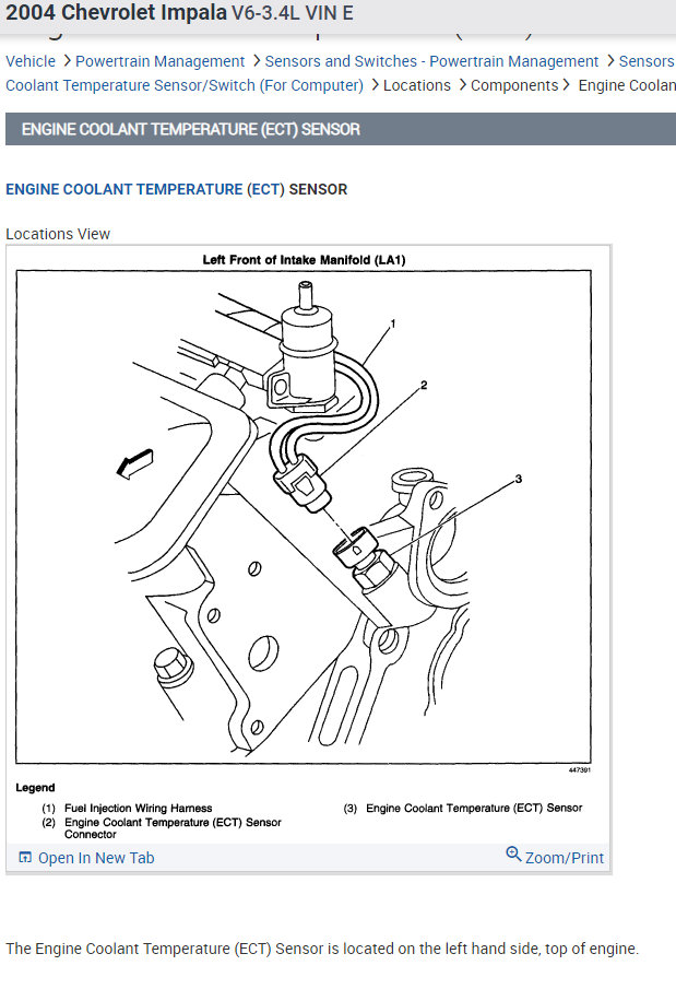

The coolant temperature sensor is located on left front intake manifold.

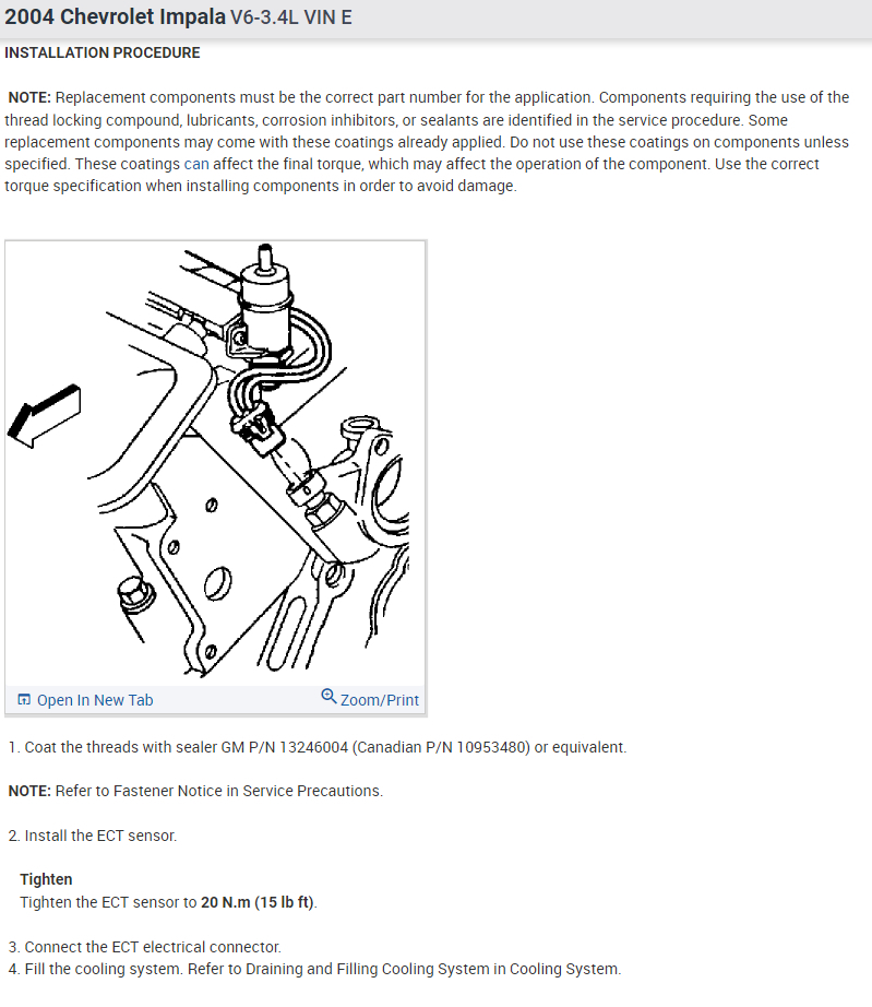

It can be changed out using simple hand tools.
Just remember to work on it when the engine is cool.

I have attached the coolant temperature sensor replacement procedure for your reference.
