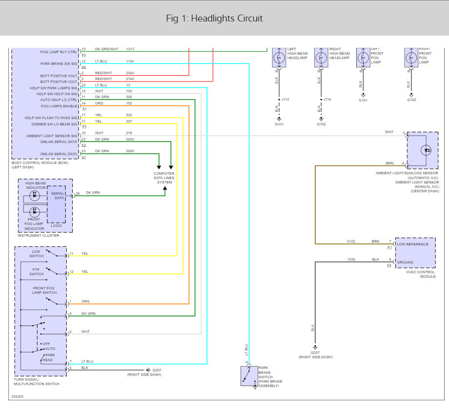

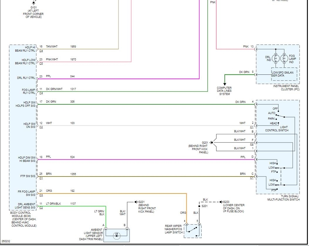

Both headlights seem to be out at the same time, except when switched to "on" and highbeams activated. Do not work when set to auto, and when on, the high beams do not seem to be as bright as before. Do not work in any other configuration, and do not have daytime running lights. Would both lights be affected if one bulb were burnt out?

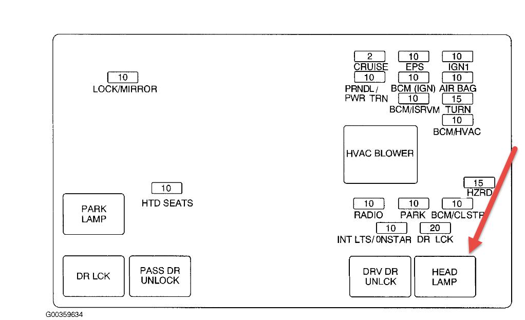

First check fuses,9, 28, 10, 52, with a test light. If ok then check low beam relay for power.If ok get back to me
See the guides below on testing wiring and relays
Attached below is the wiring diagrams for your headlights

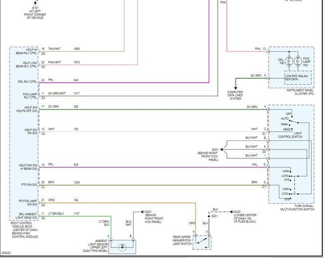

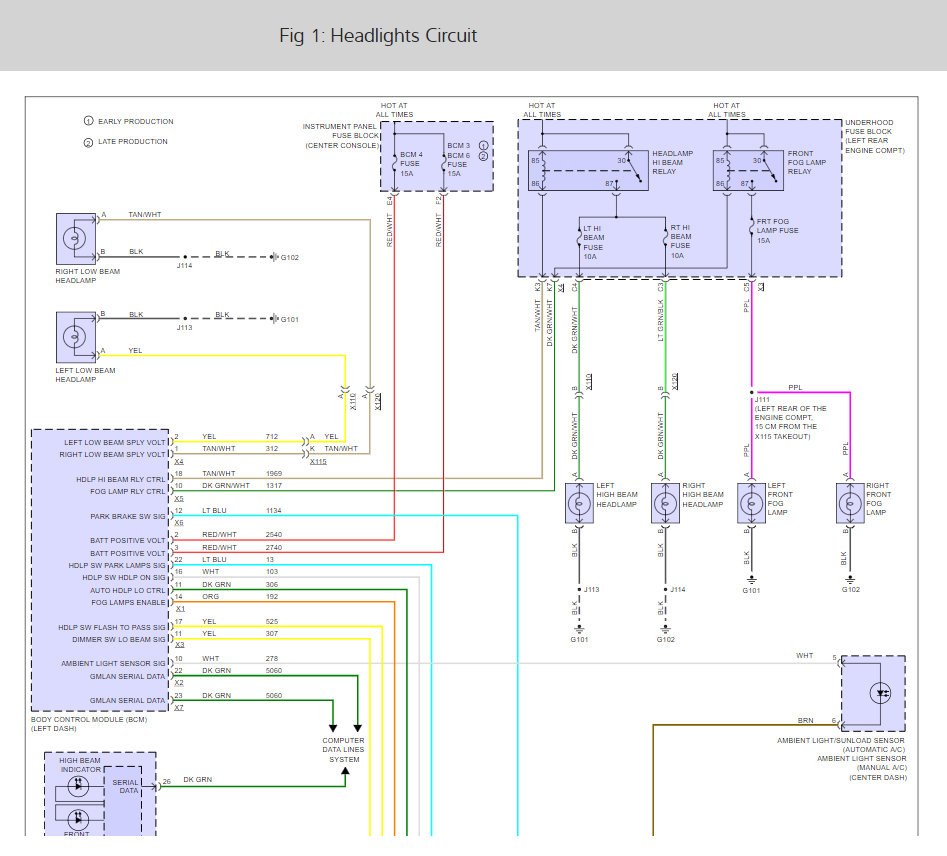

I am giving you the wiring diagram for the exterior light system which includes the headlights.
If you look at the power wire that is on the side of the relay that would not be hot until the relay is tripped you can see that the day runner lights, DRL, and the low beams share the same power wire. It may have come loose somewhere and that could happen before the fuses are reached, so it would not blow the fuses and it would have to be loose after the node where the hot lines come off of the relays and share a wire until they split into seperate nodes for each. The color is on the diagram and the wire would be a heavy gauge.
Besides the coincidence of both relays failing at the same time or the body control module, BCM, having some issue that affected both, the ground wire is the only other thing I can think of. The ground for the low beams and high beams have a common mount point, but do not share a common ground wire which is the ground wire for both the DRL and the low beams. So, it could possibly be broken or loose as well.

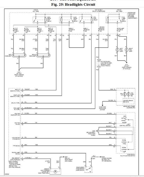

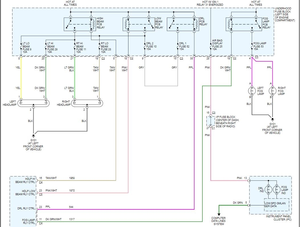

Here are the headlight wiring diagrams so you can see how the system works along with a guide that will show you how to check the wiring.

My headlights won't turn off (when in auto and I turn the car off). I tried a few things (put the horn relay in the place of the headlight relay), switched out the under the dash fuse, etc. I then noticed smoke coming out of the light controls near the steer wheel. I looked up the diagram for the wires, and pulled the running lights and high beam wires. The smoke stopped, and the lights are finally off. However, I can only drive during the day now. My question is, what do I do next?
Wednesday, March 6th, 2019 AT 6:13 PM (Merged)
HMAC300
  • 48,601 POSTS
Have a pro look at it as the harness may have burnt up to the multi function switch. Especially with the smoke. Unless you left something over the light sensor you can also check the headlight relay behind center of dash but it may be a body module so a pro will need to scan it to see if there are any code. You might try swith ing the headlamp relay with a like one and see if that cures it as the relay may have stuck. See diagram
