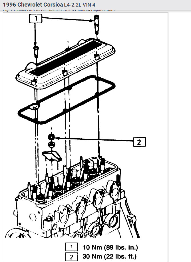

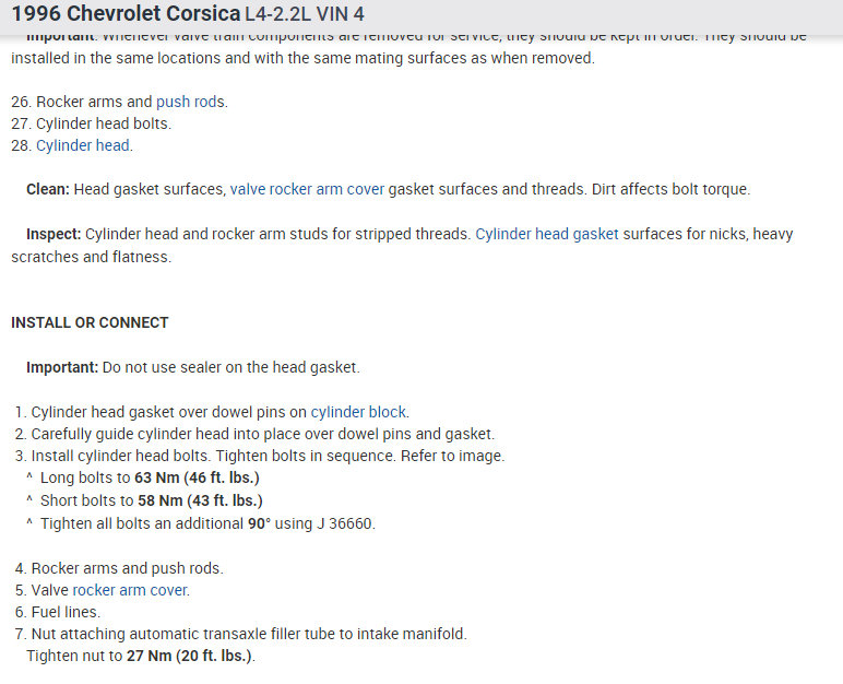

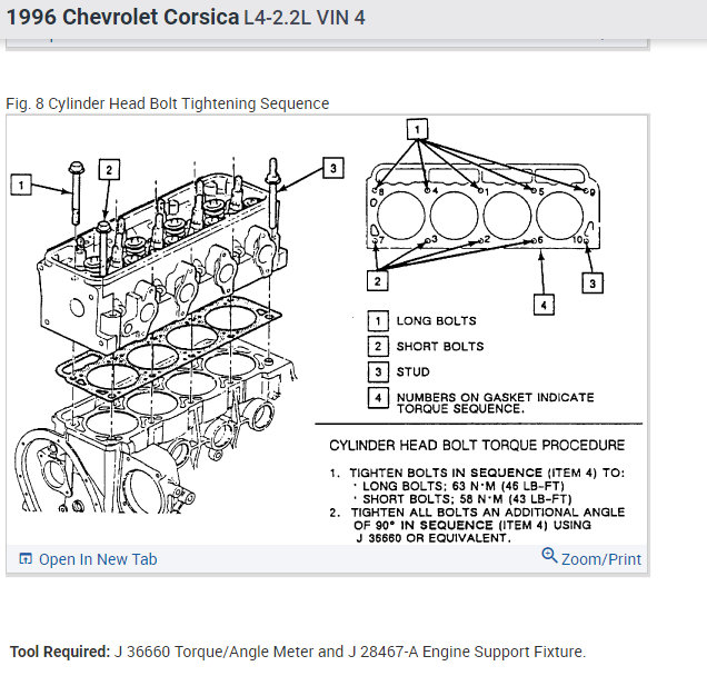

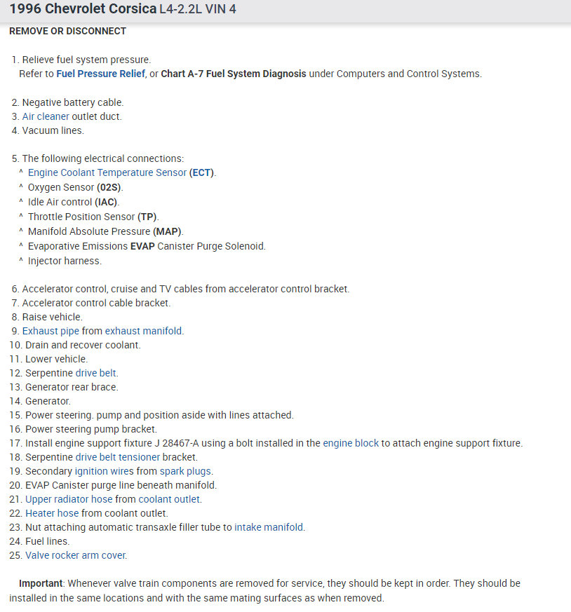

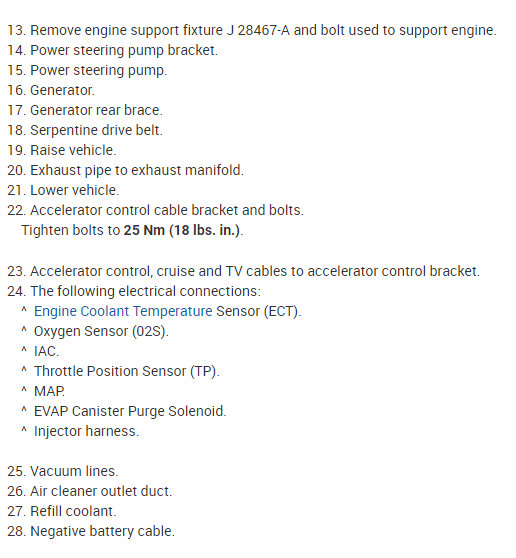

I have attached the head gasket replacement procedure, including the torque specification below.
