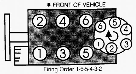

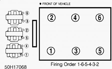

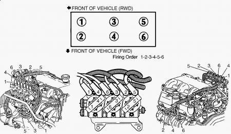

I need the firing order of the spark plugs.
Wednesday, November 18th, 2009 AT 2:00 PM
MERLIN2021
MECHANIC
17,250 POSTS
Top pic is 3.1 and 3.4 middle is 3.3 and 3.8 and bottom is 4.3
