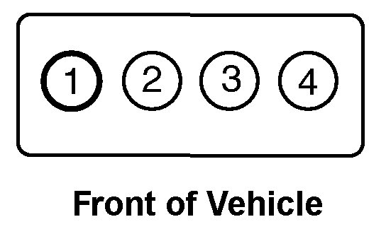

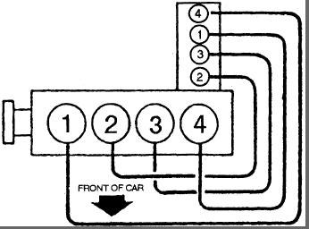

What is the firing order?
Saturday, October 3rd, 2009 AT 7:56 PM
15 Replies
JDL
  • 16,098 POSTS
https://www.2carpros.com/forum/automotive_pictures/170934_95_corsica_firing_order_1.jpg
2.2 vin G Firing order 1-3-4-2

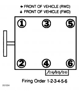

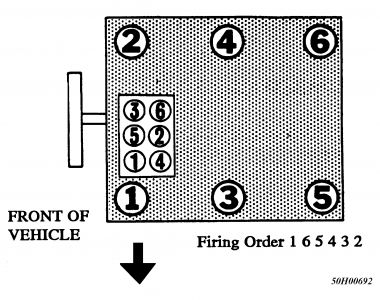

I have recently replaced all my wires and plugs but think I crossed a wire and am trying to figure out the order from each coil to plug
Monday, January 18th, 2021 AT 11:53 AM (Merged)
JDL
  • 16,098 POSTS

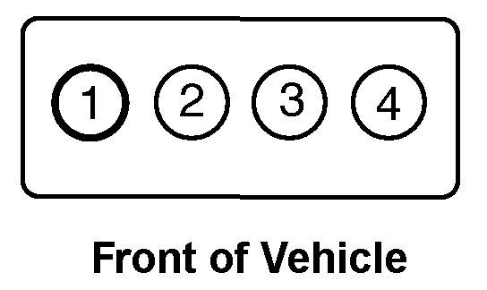

https://www.2carpros.com/forum/automotive_pictures/170934_corsica_firing_order_1.jpg
hello, the above info is for a 3.1

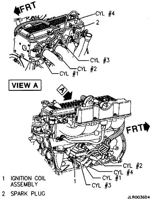

JACK BACK
Need diagram of firing order for 95 Corsica 2.2 L
Monday, January 18th, 2021 AT 11:54 AM (Merged)
  • 110,194 POSTS
Take a look through the attached pics and let me know if they help. The last picture is for wire routing. Here is the actual firing order:
1995 Chevrolet Corsica L4-2.2L VIN 4
Ignition Firing Order
Vehicle Powertrain Management Ignition System Firing Order Specifications Mechanical (including Torque) Ignition Firing Order
IGNITION FIRING ORDER
Firing Order. 1-3-4-2
Let me know if this helps.

need to know the firing order for a 1990 chevy corsica four cylinder
+1
JDL
  • 16,098 POSTS

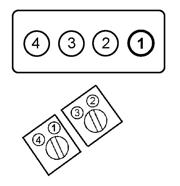

https://www.2carpros.com/forum/automotive_pictures/170934_corsica_2.jpg
the picture may be different depending on the VIN, but the firing order is 1342

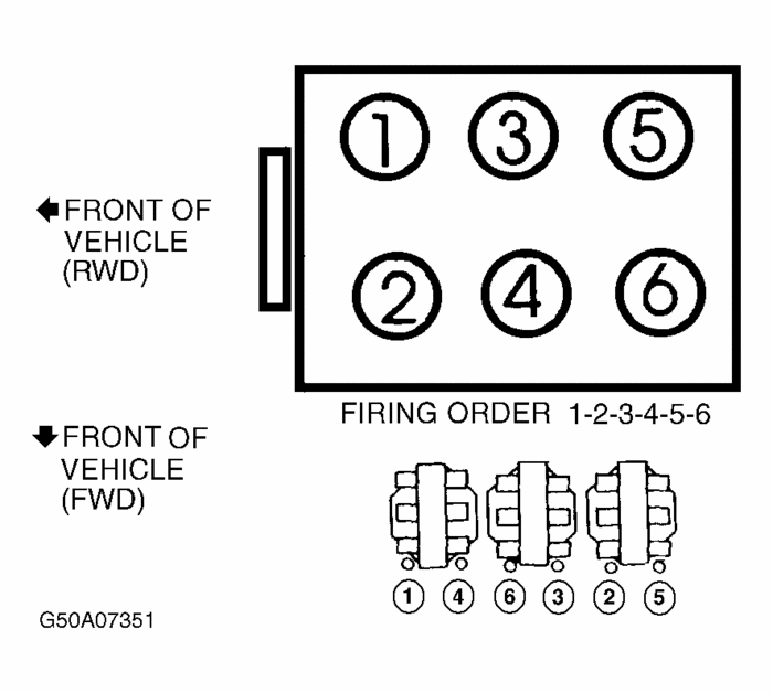

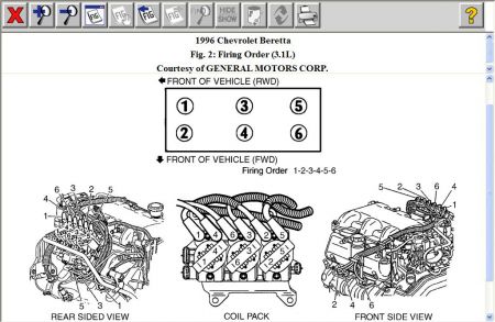

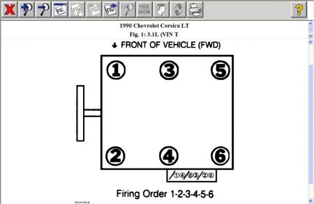

Hello how are yall doin I really have to question the first is what's the firing order the car above and what's the firing order on a 1996 chevy beretta the reason I asked for dat one because I tried to wire the corsica up like that one thinking it might have the same firing order now I got it off track too thanks for yur help

BMRFIXIT
  • 19,053 POSTS
This is 3.1 L
2nd pic 3.3L
3rd pic 3.8L
https://www.2carpros.com/forum/automotive_pictures/99387_Graphic_26.jpg
https://www.2carpros.com/forum/automotive_pictures/99387_Graphic2_5.jpg
https://www.2carpros.com/forum/automotive_pictures/99387_Graphic2_6.jpg

  • 75,992 POSTS
3.1L
https://www.2carpros.com/forum/automotive_pictures/12900_fo_3_1.jpg
96 Beretta
https://www.2carpros.com/forum/automotive_pictures/12900_96_beretta_1.jpg

If it is a 6 cylinder the cylinder numbers are
at the front 2-4-6
at the back 1-3-5
The firing order is 1-2-3-4-5-6
If it is a 4 cylinder the cylinder numbers are (drivebelt end to transaxle end)
1-2-3-4
The firing order is
1-3-4-2
