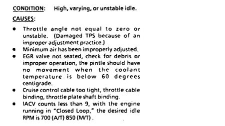

Intermittent issues can be hard to track. You have to test when the problem is ongoing. In those years, they had a lot of trouble with maf sensors, so they changed the system to a speed density system, uses the map sensor input. They changed the memcal in the computer. I don't know if that conversion was done on your vehicle? I'd remove the throttle-body and clean it, all passages, check the iac and tps.
https://www.2carpros.com/forum/automotive_pictures/512072_corsica_idle_1.jpg
