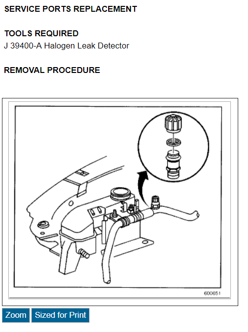

Where is the fitting to recharge ac?

You must charge the system on the low side fitting which is on the larger refrigerant line coming from the firewall here is a video to help you find it and the location below for the fitting.
https://youtu.be/uZrQCGwXfek
and
https://www.2carpros.com/articles/air-conditioner-how-to-add-freon
Cheers
