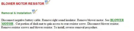

I have no low Heater/AC fan speeds. I believe I need to replace the fan resistor. Where do I find it on the car and how do I replace it?

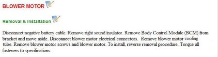

Resistor is on blower motor, located behind passenger side of dash..
https://images.2carpros.com/forum/automotive_pictures/261618_Noname_562.jpg
https://images.2carpros.com/forum/automotive_pictures/261618_Noname2_143.jpg
