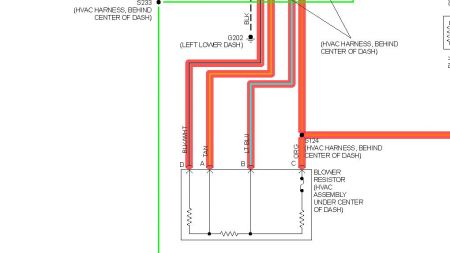

What is wrong with the blower when it only runs on high?
Saturday, September 20th, 2008 AT 9:07 PM
MECHANIC
75,992 POSTS
Test the blower motor resistor see below for location
