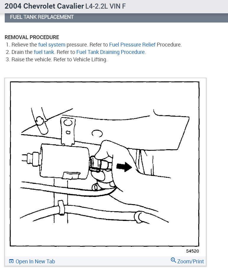

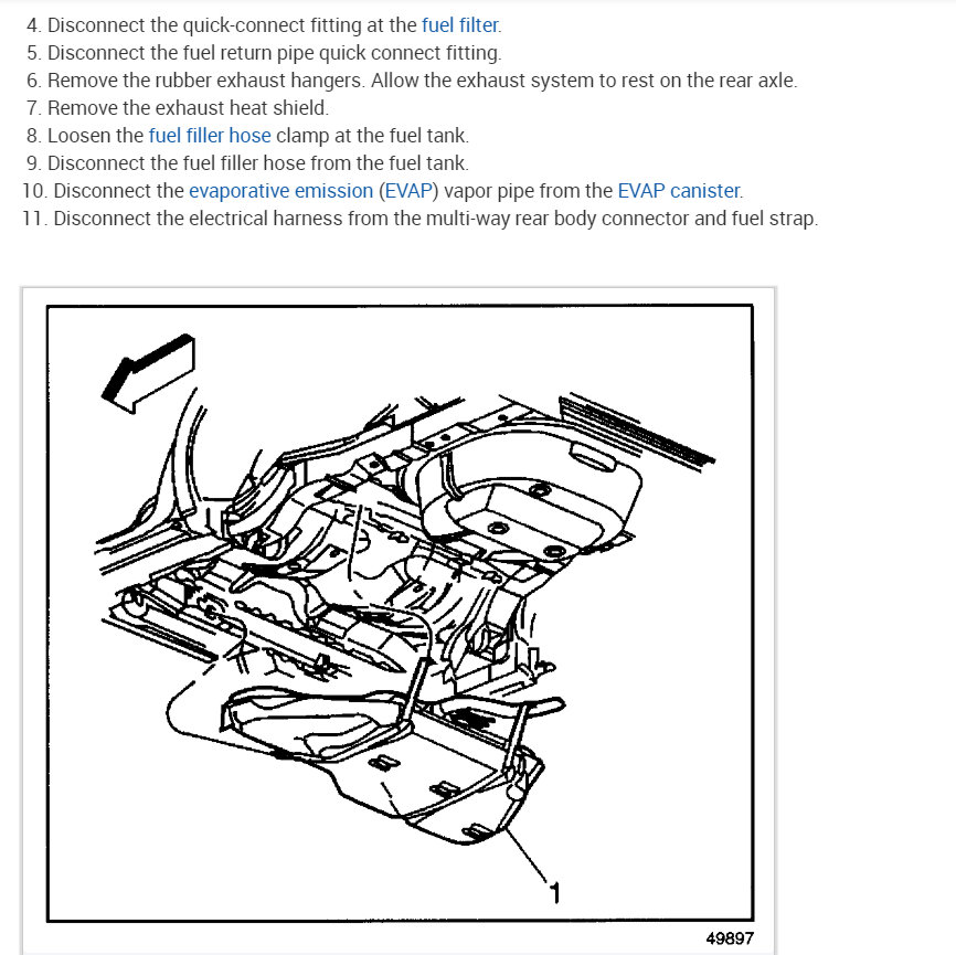

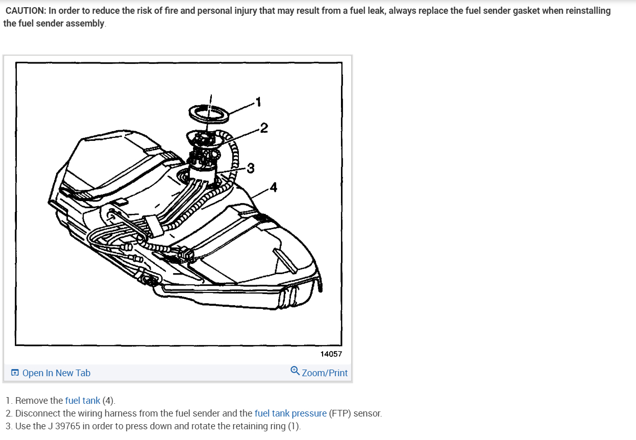

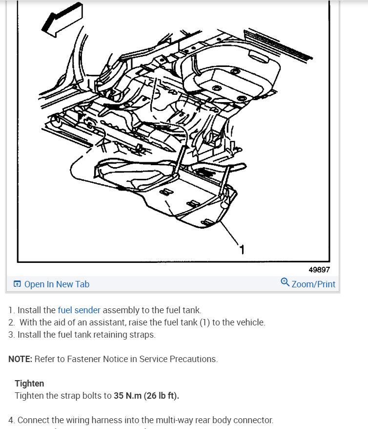

I would think the fuel pump is going out which is common on these cars here is a video and a guide to help you fix the issue.
https://www.2carpros.com/articles/engine-stalls
Here is a video to help you change the pump out.
https://youtu.be/Lhd0vd8pdBU
