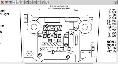

1992 Chevy Cavalier 4 cyl Front Wheel Drive Automatic
I don't have a distributor. I have no fire at all and I have replaced the coil packs and the Ignition module I need to know what sends the signal from the block to the module.

Check and test the crankshaft position sensor.
Friday, January 1st, 2010 AT 8:55 PM
JAHAMPT
Where is the crank pos. Sensor located?
Friday, January 1st, 2010 AT 9:47 PM
  • 75,992 POSTS
At timing belt end of engine below alternator-sorry no pic won't load up
Friday, January 1st, 2010 AT 10:31 PM
JAHAMPT
Is that belt the one that goes around the alternator?
Friday, January 1st, 2010 AT 10:58 PM
  • 75,992 POSTS
The CPS is located at Z see below
http://www.2carpros.com/forum/automotive_pictures/12900_cps_38.jpg
Saturday, January 2nd, 2010 AT 5:09 AM
JAHAMPT
How do you check the CPS? Does my car have a timing chain or a timing belt, I only see the belt around the alternator. And I need to know how to get to the CPS I don't have a repair manual.
Saturday, January 2nd, 2010 AT 10:42 AM
JAHAMPT
The crankshaft position sensor is not behind the alternator it right below the coil pack. But my question can I get a Diagram and a step by step electrical current box sent to my email at Jahampt@yahoo. Com the step by step thing is for the 3 30 amp things by the windshield on the passenger side of the car by the heater motor. It's a 1992 Chevy Cavalier 2.2L RS 4 cylinder.
