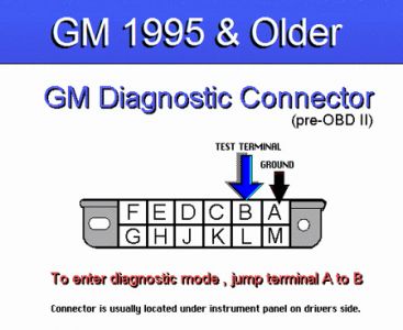

Is the ses light on? Check the codes, heres how. Cross the two terminals as shown, then turn the key to "ON" but do not start it, then count the flashes, a 22 will flash as 2 blinks then a short pause the 2 more blinks. If more than one code is stored, the pause will be longer before it is flashed. This will repear three times then a code 12. Write down your codes and post here. Your last tune-up with filters was?
http://www.2carpros.com/forum/automotive_pictures/62217_95_OlderGM_4.jpg
