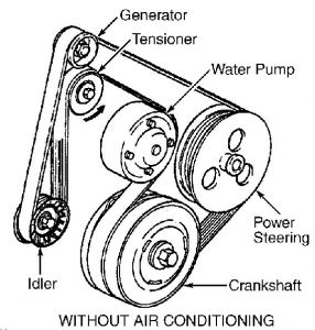

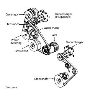

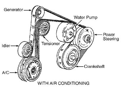

Whats the location of the belt tensioner on a 1997 camaro v6 3800 engine?
Wednesday, October 31st, 2007 AT 2:12 PM
BMRFIXIT
MECHANIC
19,053 POSTS
Thanks to mitchell1 and if u cant see them let me know
good luck
