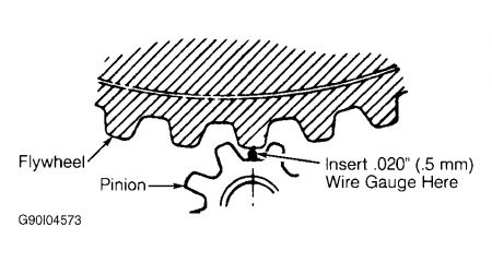

why does my starter housing keep braking everytime I try 2 start it
Sunday, September 26th, 2010 AT 12:02 AM
DOCFIXIT
MECHANIC
18,828 POSTS
Pinion gear clearence to close may need shiming see diagram
Also check flex plate starter ring for strightness. Do not torque more than 35 ft. lbs.
