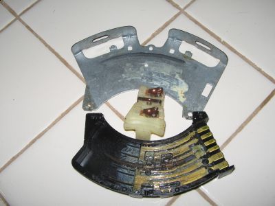

Here is a picture of my switch the contacts don't look good I'm going to Napa to get a new one today. Notice the purple wire, it goes to the solenoid I believe. Have you tried a jump wire from your solenoid to your battery yet? And mine wouldn't start in nuetral when it was really warmed up either.
https://www.2carpros.com/forum/automotive_pictures/454833_89_camaro_2009_003_1.jpg
https://www.2carpros.com/forum/automotive_pictures/454833_89_camaro_2009_004_1.jpg
Well thats not it. Started fine then nothing again I'm going after the security system relay now.
Thursday, December 31st, 2009 AT 1:09 PM

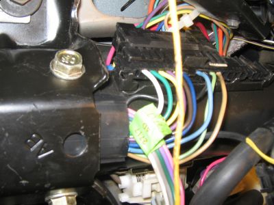

Found no continuity in one of my ground connections coming out of my steering colum. I pulled it apart and the connections looked fine so put back and it showed continuity so tried the key and it started. Don't ask why. Heres a pic of it. Ground is third from right black wire
https://www.2carpros.com/forum/automotive_pictures/454833_89_camaro_2009_006_1.jpg
Also found that someone had allready bypassed the resistor in the key. Heres where they added a resistor to the wiring.
https://www.2carpros.com/forum/automotive_pictures/454833_89_camaro_2009_007_1.jpg
It was right above the connection I was checking.
Wednesday, January 6th, 2010 AT 11:19 AM

Hey, good job, glad you got it going. I tried to find a wiring diagram for your ignition switch, haven't found anything. Sometimes, it's hard for me to find info on older models.
If the theft system had a problem that didn't involve the pellet in the key or wiring in the column, that resistor wouldn't help anything.
