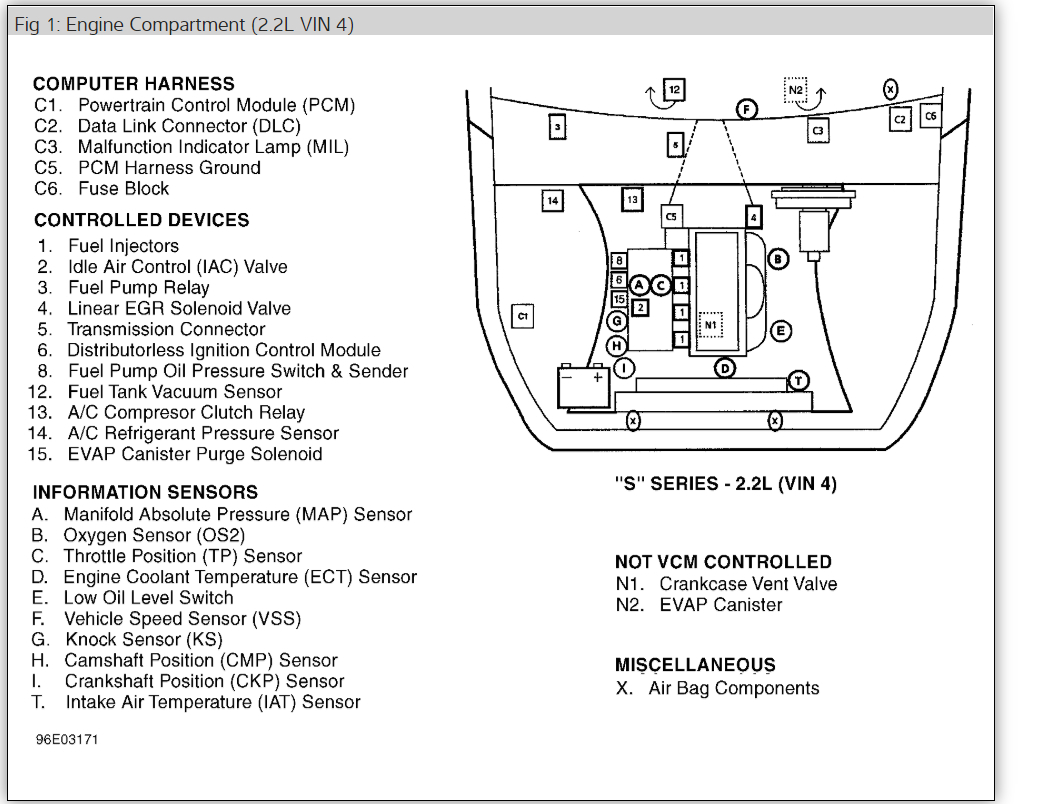

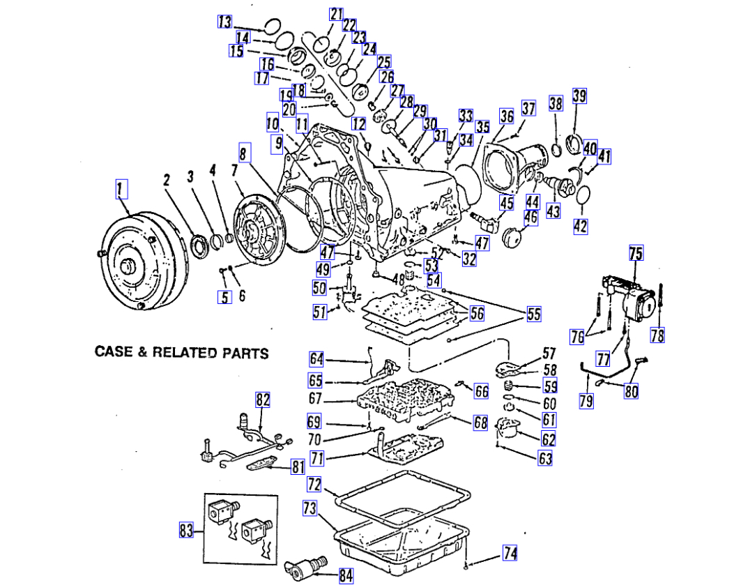

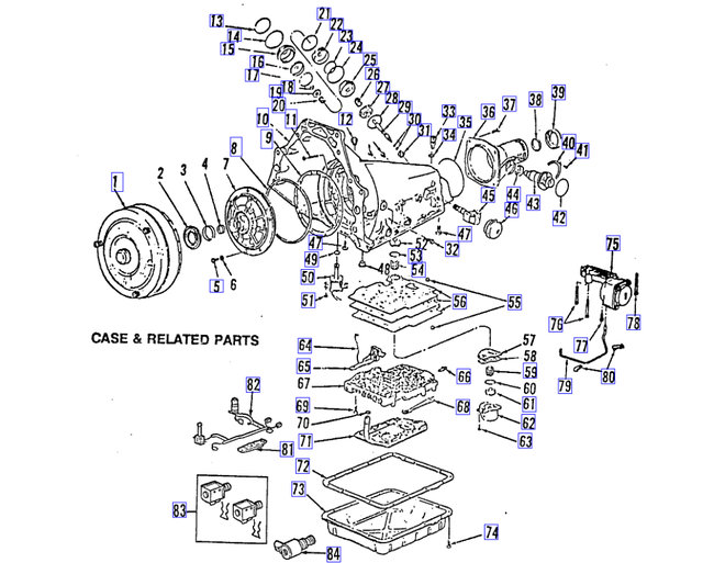

KATLINUHL5727
  • 1996 CHEVROLET BLAZER
  • V6
  • 2,157,877 MILES
ABS light came on speedometer quit working and will not shift into third or fourth gear. Showed no signs of transmission failure.
Friday, April 9th, 2021 AT 7:12 PM (Merged)
KEN L
  • MASTER CERTIFIED MECHANIC
  • 55,322 POSTS
It sounds like the vehicle speed sensor (output shaft speed sensor) has gone out. Here is its location so you can replace it. F and #43 in the diagrams.
Check out the diagrams (below). Please let us know what you find.
BRYANK36
It was the vss thank you.

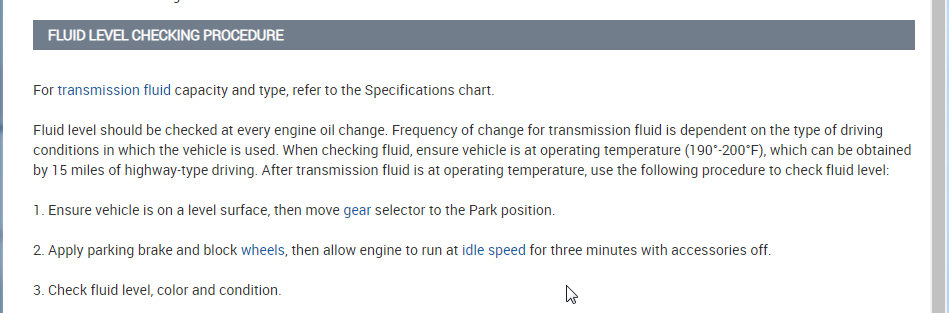

MELODY THOMAS
  • 4.3L
  • 6 CYL
  • 4WD
  • 500,000 MILES
From left to right, gear arrangement appears on dashboard as ordered:
Park
Reverse
Neutral
Overdrive
Drive
2nd
1st
She fires up without a hitch, smooth exchange from idle point, and purrs in reverse, but lacks follow thru on acceleration.
Instead of maintaining current speed by depressing the throttle, something disengaged.
Having to drop shift into 2nd around the 15 MPH marker for continued travel, and upshifting back to drive at a full stop, to be a two geared shit shifter when all I want is my automatic transmission back.

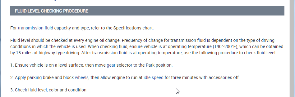

We need to start with the basics. Let's inspect the fluid level and condition. If the fluid is dirty we may need to start with changing it but that is also a sign that the damage is already done and it won't fix it.
So if the fluid is dirty then that is normally caused by a clutch slipping and it burns the fluid which causes more damage and eventually you lose forward gears first and then reverse in most cases.
Below is the process to check the fluid.
Then we need to check for codes.
Let's start with this and go from there. Thanks

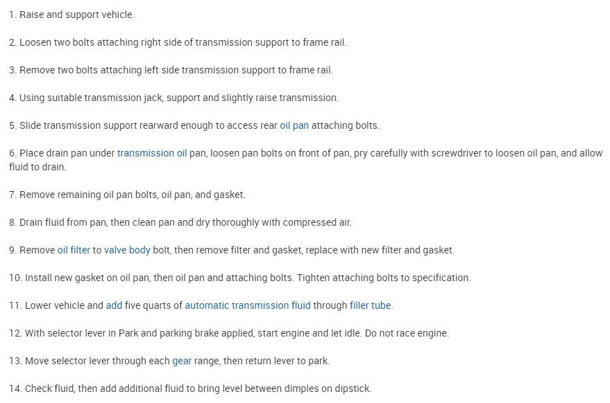

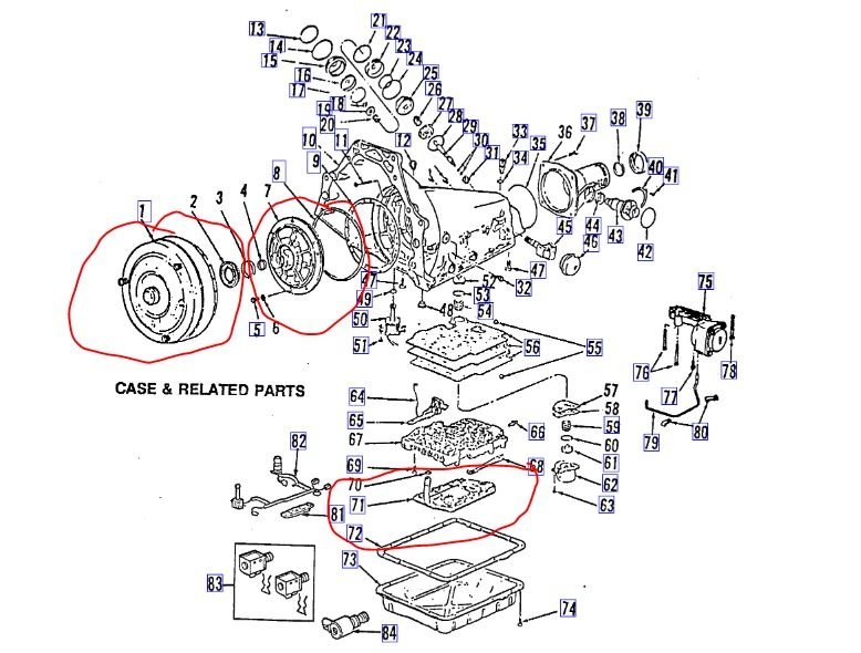

CRIDDLE
  • 4.3L
  • 6 CYL
  • 4WD
  • 200,000 MILES
Why is my transmission not going into drive and high rpm.

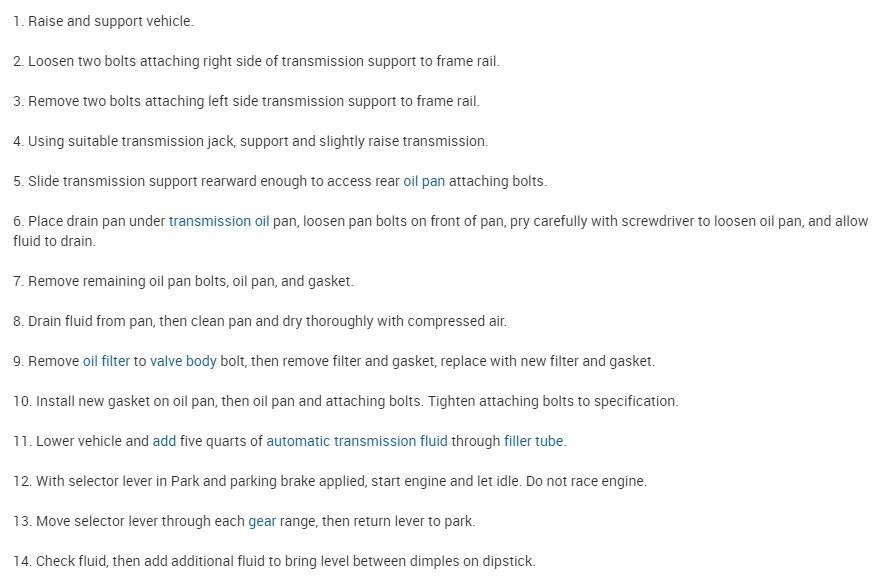

Good morning,
The first thing is to check your fluid and make sure it is correct.
It could be a clogged filter in the transmission. I would drop the pan and change the fluid and filter.
Beyond that, you may have a failed torque converter or front pump failure. That will require removal and inspection.

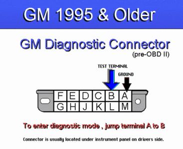

MIKE H R
  • 3,094 POSTS
Have you had the transmission scanned? there are many reasons for slippage, there are a few codes that relate to the slippage. ex, 75- low voltage, 73-pressure control, 69, torque comverter. The problem could be in one of the electrical solenoids that control the transmission. Or a bad connection
https://www.2carpros.com/forum/automotive_pictures/54223_blazer_solenoids_1.jpg
+2
CONVERTERKID2000
  • 12 POSTS
No I haven't had it scanned yet. Didn't want to drive it to far with this problem. What kind of scanner do I have to get to scan this. And do you plug it into the same port you use for the engine? Also like I said 1st 2nd and reverse work fine. Hopefully it is something in the valve body so I don't have to pull the tranny out again.
