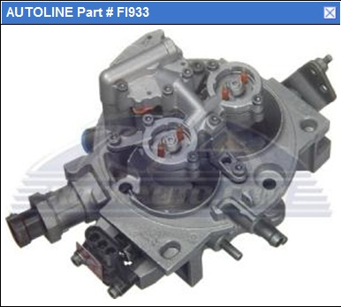

What is the procedure for installing a kit in the fuel pressure regulator of an 1989 5.7 K5 Blazer TBI?
Monday, December 28th, 2020 AT 11:45 AM (Merged)
JDL
  • 16,098 POSTS
Make sure no pressure on system, Remove top torque screws, the autostore sells a fitting to remove those. You should be able to remove only the top part. Picture below.

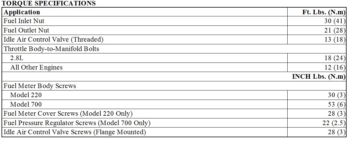

TRASKRIVERJACK
And then what? I understand the regulater is under spring pressure. How to disassemble, reassemble, and what are the alignment issues, and torque values for the fasteners?
JDL
  • 16,098 POSTS
You shouldn't have any problems, just put it back together the way it came off. I don't use a torque wrench on screws that small, maybe I should? Torque specs are below.
