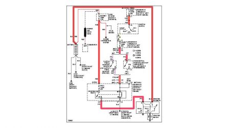

The lights come on but I go to start it and I get nothing. No clicking or turn over sound.

Test the battery if okay make sure its cleaned and properly tightened then comeback

Everything seems connected fine. I don't see and corrosion around the hook up. The headlights and overhead light are coming on and so is the radio.

Check Ign C fuse 20amp and crank fuse 10amp if okay do below
Have a helper hold key at start position-you check for power at the purple small wire at the starter solenoid-do you have it ? If so the starter is defective if not come on back-refer to start EWD below
http://www.2carpros.com/forum/automotive_pictures/12900_start_1.jpg
