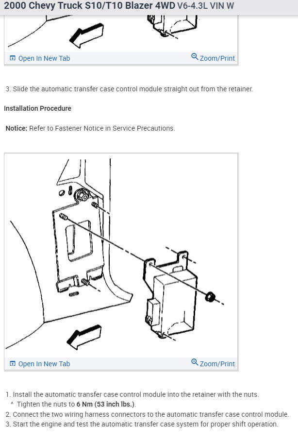

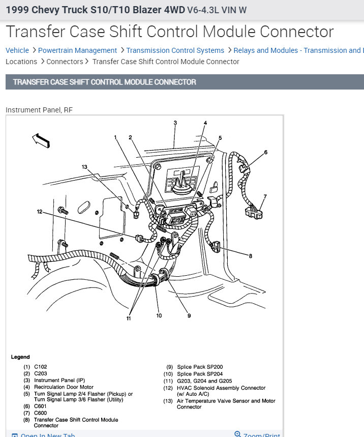

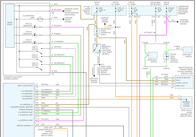

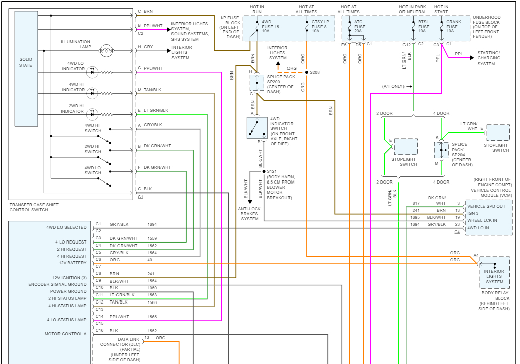

Why does the 4x4 switch does not light up only flash but does stay stable.
Tuesday, December 15th, 2009 AT 8:27 PM
SQM
  • 6,383 POSTS
If the switch does not light up, but the vehicle actually engages to four-wheel drive, then the issue is a bad switch.
If the light flashes and the vehicle does not engage 4x4 then the issue could be a faulty transfer case control module.
This can also be due to bad wiring.
Please let me know what you are experiencing.
