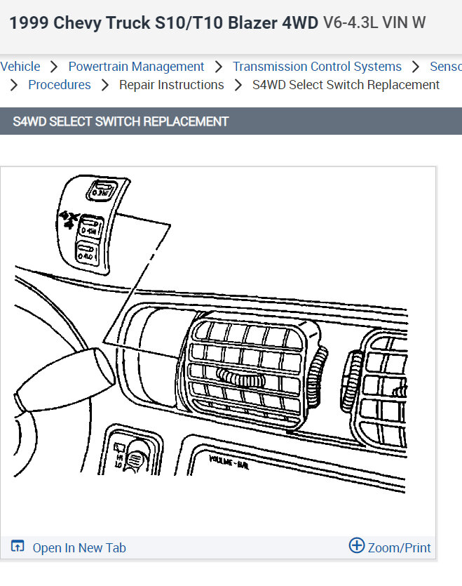

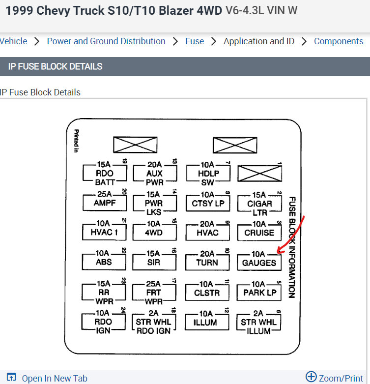

This happens when the gauges fuse blows or the transfer case selector switch goes bad. Here is the location of the fuse and how to change the switch out in case the fuse is good.
