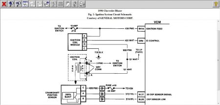

While driving, it just stopped running. No warning. Nothing. I have replaced the ignition coil, module and crank sensor. All new parts. Nothing. There is power to the pink wire at coil and module with key on. I've tried grounding the black/white wire at module plug and get some spark from the coil. All fuses good. Running out of ideas and money. Suggestions?

With key on should have check engine light on, do you?
Crank engine light should go out, does it !
Use a scanner and check for codes

Recheck the CPS wiring and voltage on the pink wire to it not there check fuse no.10 20 amp-fuse okay and wiring the problem is with the computer
http://www.2carpros.com/forum/automotive_pictures/12900_ign_1.jpg
