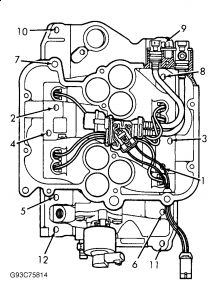

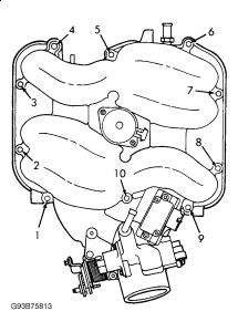

OBXAUTOMEDIC
  • 3,711 POSTS
Hey Keith,
Guess I should have posted the specs also before you had to ask for them. Anyway, here they are....
Lower Intake Torq is 35 foot pounds
https://www.2carpros.com/forum/automotive_pictures/188069_4_3lowerintaketorqseq_1.jpg
Upper Intake Torq Is 10 foot pounds
https://www.2carpros.com/forum/automotive_pictures/188069_4_3upperintaketorqseq_1.jpg
