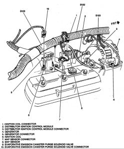

I'll look for the ignition module. The Mitchell schematics show it as a separate unit but the coil module on the vehicle has two low voltage connectors. Maybe the ignition module is just mounted on the same assembly as the coil.
Could you detail the sequence of spark firing? I think it is, crank sensor sends signal to VCU which sends control signal to ignition module. That triggers the coil to generate spark then through the distributor to the plug. Where does the cam sensor come into this path? According to the schematic, the two sensors are like switches providing circuit closure to the VCU. They do not provide ground.
I am trying to zero in on the places to look since there is very little room to see anything in the engine compartment.
Thank you soo much for your responses.
Wednesday, September 1st, 2010 AT 11:02 AM
WRENCHTECH
  • 20,761 POSTS
It's #2 in the picture
https://www.2carpros.com/forum/automotive_pictures/561653_Ignition_module_97_43_1.jpg
Wednesday, September 1st, 2010 AT 11:30 AM
WINGS515
  • 12 POSTS
Thanks for the picture. It came out kinda small. I think I see a 2 near and to the left of the alternator. Is that it? The front of the engine is to the right, correct?
Wednesday, September 1st, 2010 AT 11:36 AM
WRENCHTECH
  • 20,761 POSTS
Yes, that is a view from the right side so it's right behind the alternator. Sorry, the site reduced the picture.
