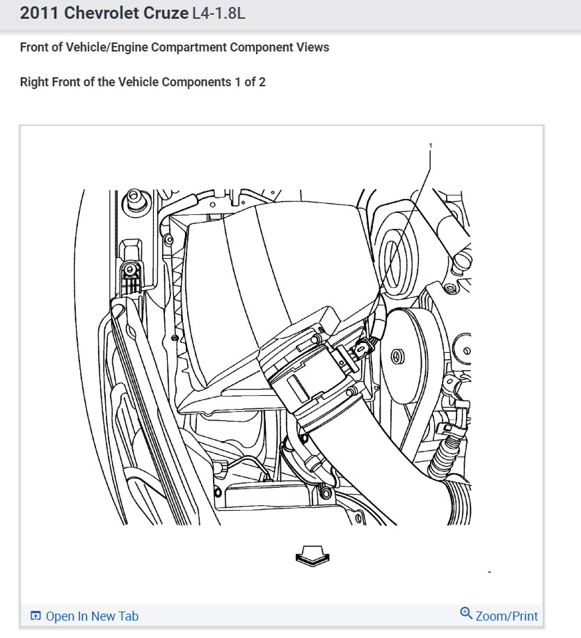

The P0300 is a random misfire not misfire on #1 which can be caused by a dirty throttle body, bad gas, or a bad MAF sensor. Here is a guide to help you clean the sensor and the location in the diagrams below for your car:
https://www.2carpros.com/articles/mass-air-flow-service

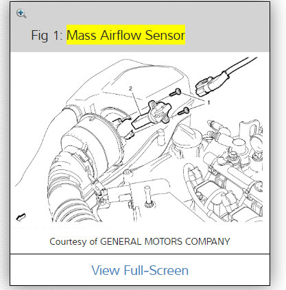

Even though you cleaned the MAF if it is too far gone it will not help I would replace the sensor with a new unit AC delco. Here is one on Amazon for 49.00
https://www.amazon.com/gp/product/B00BHGURHW/ref=as_li_qf_asin_il_tl?ie=UTF8&tag=2carprcom-20&creative=9325&linkCode=as2&creativeASIN=B00BHGURHW&linkId=bdf16fef0565bc3cf6b475181d035f0f
Here is a guide to help walk you through the replacement steps and diagrams below to show you on out car.
https://www.2carpros.com/articles/how-to-replace-a-mass-air-flow-sensor-maf
