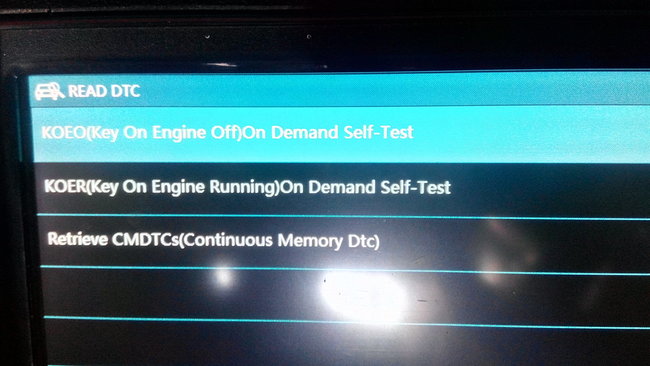

Hi Steve,
Still have CEL but no more code what the diagnostic tool read was:
KOEO (Key Engine Off) demand self test
KOER (Key Engine Running ) demand Self test
Retrieve CMDTCs(Continuous Memory DTC)
here's the photo
Tuesday, May 9th, 2017 AT 5:23 PM
STEVE W.
  • 15,671 POSTS
OK, those should be menu items you select to make the tool read the codes. For instance the :
KOEO (Key Engine Off) demand self test when selected and OKed will scan the system for codes that are set and turning on the light.
Retrieve CMDTCs: are items that are scanned constantly like crank sensors, throttle position sensors, battery voltage and such. Those can set a pending code which if the problem stops will erase itself without setting a light.
What make model is the scan tool you have? I'll look up the manual and see what else it can do that might help you.

This is the image you posted earlier. That should be a selection menu. You pick one of the options and let the system run the test. From a book covering these tests -
Quick Test
The quick test is divided into 3 specialized tests:
1. Key On Engine Off (KOEO) On-Demand Self-Test
2. Key On Engine Running (KOER) On-Demand Self-Test
3. Continuous Memory Self-Test
The quick test checks the integrity and function of the electronic engine control (EEC) system and outputs the test results when requested by the scan tool. The quick test also provides a quick check of the powertrain control system, and is usually carried out at the start of each diagnostic procedure with all
accessories off. The quick test is also carried out at the end of most pinpoint tests for verification of the repair and to make sure no other concerns are incurred while repairing a previous concern. A system pass is displayed when no diagnostic trouble codes (DTCs) are output and a scan tool communication error does not exist. System pass means that hardware monitored by the powertrain control module (PCM) is
functioning within the normal operating limits. Only a system pass, a DTC, or an incomplete on board diagnostic (OBD) drive cycle (P1000) is displayed.
The KOEO on-demand self-test is a functional test of the PCM carried out on-demand with the key on andthe engine off. This test carries out checks on certain sensor and actuator circuits. A concern must be present at the time of testing for the KOEO self-test to detect the concern. When a concern is detected, a DTC is output on the data link at the end of the test as requested by the scan tool.
The KOER on-demand self-test is a functional test of the PCM carried out on-demand with the key on, the engine running and the vehicle stopped. A check of certain inputs and outputs is made during operating conditions and at a normal operating temperature. The brake pedal position, transmission control, and the power steering tests are part of the KOER on-demand self-test and must be carried out during this operation if applicable. A concern must be present at the time of testing for the KOE
R on-demand self-test to detect the concern. When a concern is detected, a DTC is output on the data link at the end of the test as requested by the scan tool.
Only after you run the tests will you see if there are trouble codes.
If you select one of the tests and the scan tool doesn't start the tests, either the DLC isn't working properly and the scan tool cannot talk to the system, OR the scan tool itself has a problem.

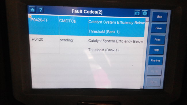

We re-scanned the car with a different scan tool and here is the result. Do I need to replace my cat converter?
Sunday, May 14th, 2017 AT 8:45 PM
STEVE W.
  • 15,671 POSTS
You already tried to clean it and you're not showing the sensor codes so I would say the convertor is bad.
