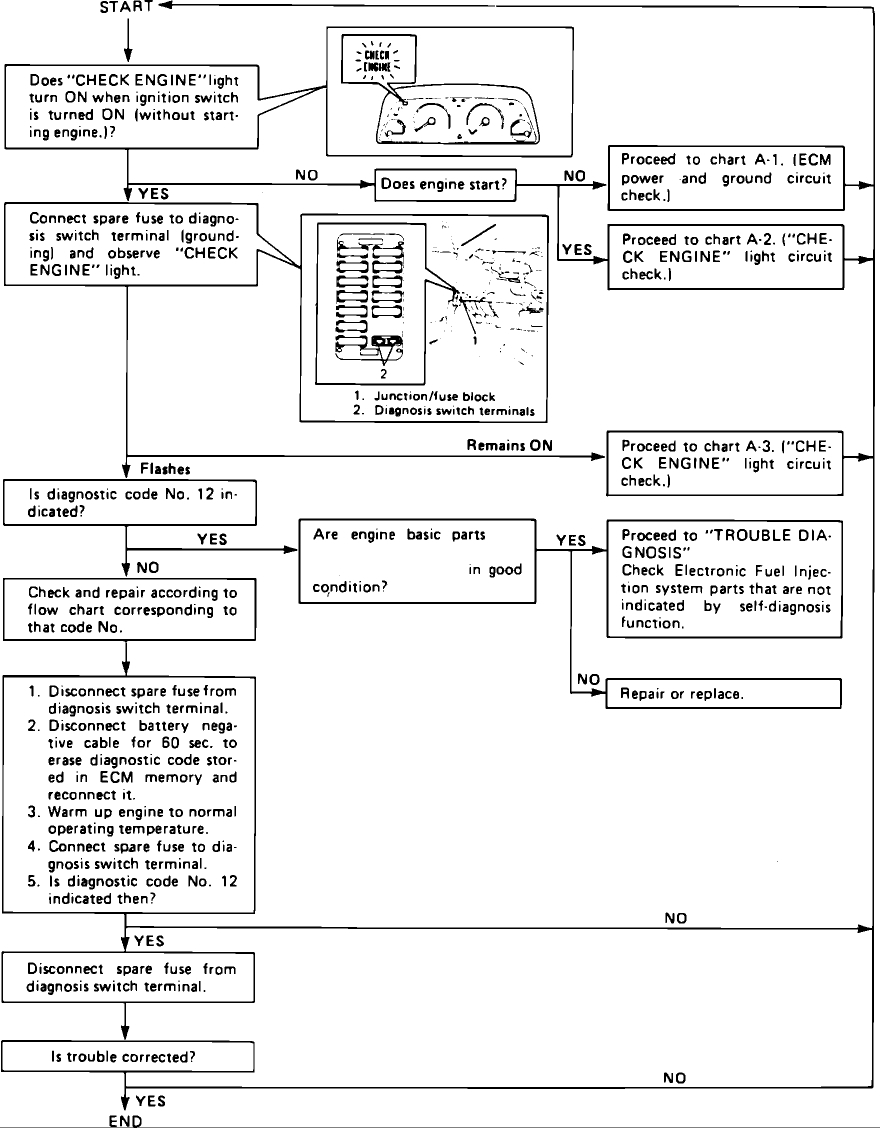

Have you actually pulled the trouble code and repaired the problem that is turning the light on?
Put the diagnostic fuse in, then read the code(s) the check engine light flashes at you.
12 All Clear (No Fault Detected).

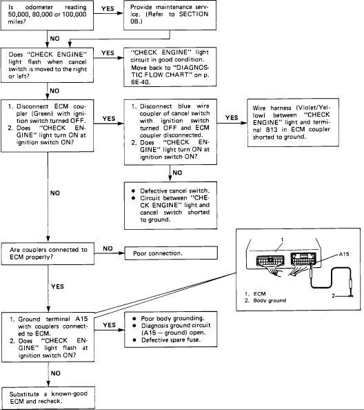

PSCHOON
  • 6 POSTS
Thanks so much for the reply. When I put the fuse into the diagnostic slot, and turn the ignition switch on, the check engine light just stays illuminated. It fails to flash a code no matter what I do.

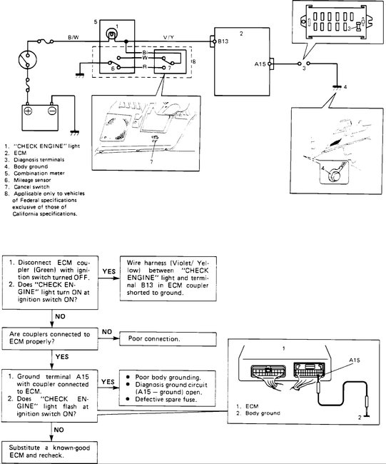

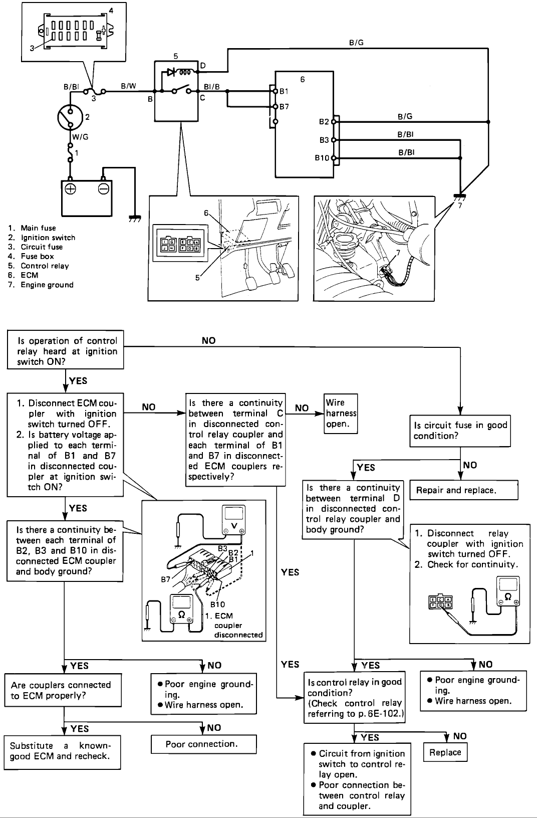

STEVE W.
  • 15,697 POSTS
That is good but it does not mean it works correctly. Did the company make sure it worked before shipping it back? The light staying on and not flashing is an ECU fault. It means it is not working. You need to be sure it is getting power and ground. I would think it is if the diagnostics worked.

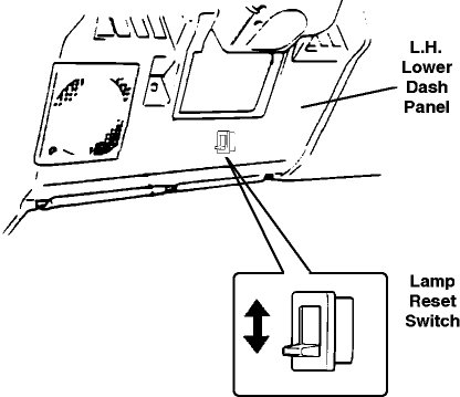

PSCHOON
  • 6 POSTS
A mechanic five hundred miles from here in Nebraska found and flipped the "secret reset switch" once, the light was off for a month. I cannot locate that switch (after hours of looking).
Thursday, September 28th, 2017 AT 12:31 PM
STEVE W.
  • 15,697 POSTS
Only switch I know of is the service due switch that was to reset the service timer. That was behind the lower left dash trim if I recall. Been a long time.
Here are some test charts to work on the issue:
+1
Thursday, September 28th, 2017 AT 1:13 PM
PSCHOON
  • 6 POSTS
Oh, wow! I was able to find the reset switch from your last image. Reset the light, and it stays off! Also, was finally able to run the ODB1 code, came up 12: Normal! Thanks so much!
