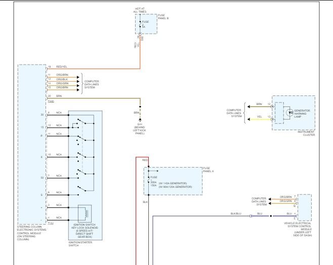

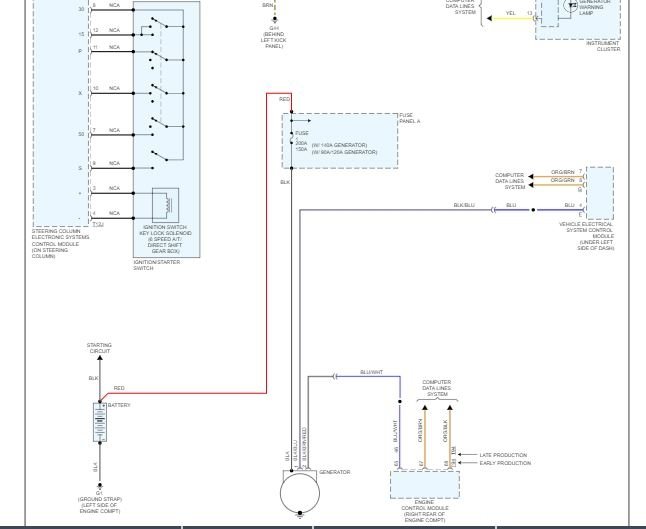

Can't locate the alternator charging fuse on my golf 5.

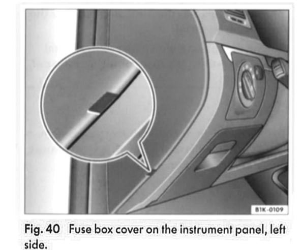

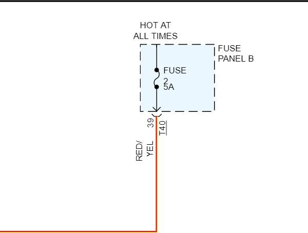

Good evening,
I attached a wiring diagram of the charging system for you and enlarged the location of the fuse panel for you to check the fuse.
Let us know if you have any other questions.
